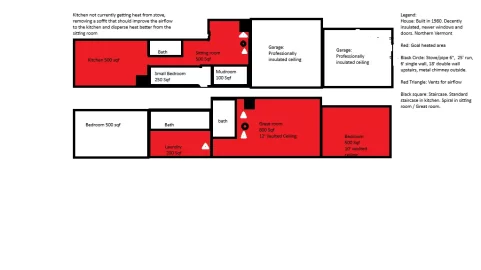

I've narrowed my stove search down to either a princess or an Ashford 30.2. I've read a lot of threads and gotten some feedback, but I'm struggling to understand the specific advantages and disadvantages between these two stoves.
Location: Northern Vermont. Usually 2 weeks below 0 F, Usually 10-14 weeks around freezing.
Area heated: ~2400 sqf
Specie burned: mix of maple, cherry, and poplar. Some pine for kindling / fire starting
Volume burned: About 6 cord / year. Goal is to keep stove running all winter with few relights.
Biggest challenge: Cooking ourselves out in the shoulder season / having to light the stove more often.
Current Stove: Manchester 8362. Maintenance issues driving search. Stove is a good performer, but we're constantly tinkering with the firebox.
Heating: Stove is primary for highlighted areas except kitchen. House also has propane rinnais and a heat pump. We aren't SOL without the stove, but it's our main heat source.

Your house problem is that the floor plan looks long and skinny with lots of interior walls. I live in Anchorage with an early catalytic King I got in early 90s. Heating 2300 sq ft (2 floors) with 6 cords. Below freezing in daytime probably 22 weeks, at night ~28 weeks.
