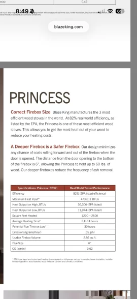

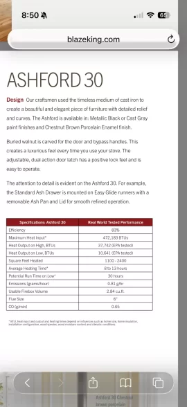

@Poindexter could you expand a little bit on why you’d choose the Princess over the Ashford?
I’m looking at the brochure, and while the princess has a slightly higher maximum BTU, the ashford is slightly higher running on high according to the brochure.
I live in northern New England and have a house built in the 80s. 2400+ heated area, not particularly drafty.
Biggest nuance right now is i have a decent amount of logs cut to 18+ and it seems like they might load better in the Ashford.
I want to buy the stove for the long term. I’m struggling to parse the pros and cons between these two stoves. Would love your opinion. Thanks!
Having used my Ashford for 1 full year now, I'm very pleased with it. My wood stove installer even wants to switch his princess for an Ashford, the traditional look is fantastic. I have the grey one.
I just installed the fan kits and they make a huge difference. In effect, the air leaving the chimney is way cooler. I can't even get the Ashford to max temp if I'm using the fans cause they blow the heat out into the room faster than it can build. In other words, the stove is cooler, the room is warmer.
Most importantly, I've cut all my logs to 19 inches and they all fit. In fact, you can do almost 21 inches if you put the back end above the stone level (in the top six inches, resting on the 19 inch ones underneath). I wouldn't recommend cutting longer than 19 though. If you cut them at 15, the extra 4 inches lost means almost 25% more trips to get wood each winter. I want a full stove in all directions.
The Ashford is a beat, my kids love it. I carry them downstairs and put a fire on for them every morning.
From what I've read, princess and Ashford are equivalent, so pick the one that looks the best.
There are some notable differences between the two. The Princess is an unappologetic hunk of steel. The Ashford cloaks the steel body in an attractive castiron jacket. The Princess a deeper firebox which means more ash capacity for less frequent ash dumping. If a cooktop is important, the Princess's top is exposed while the Ashford requires lifting the (heavy) lid off to expose the steel top.
I have cooked on princess a few times,you have room for 2 12 in. cast skillets or dutch oven.Agree with Pointdexter on stoves and operation.Crank them wide open or throttle right down. If the king ever needs replacing I would love same stove with just larger firebox.
