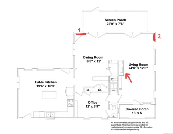

  • Based on the floor plan (attached), would an insert in the living room fireplace (see red arrow) help heat the dining area as well? What about the office? Or, should we be considering a stove in a different location?

A good insert, burning dry wood, will heat the open areas of the floor well. The Office and Kitchen area much less so due to the airflow restrictions of the doorways. This may be helped a bit by fans, but the stove and dining areas will be warmer. The liner install could be $2500 so that means a basic insert. Look at the Drolet Escape 1800 and Century CW2900. Don't be surprised if the latest tariffs cause a price spike while looking.
That's very helpful! We were wondering whether the wood stove would be able to heat the open areas because, unlike radiator units, the heat source is concentrated. This answers my question. Budget sounds tight, but we have to make do with whatever we have. Thanks for the suggestions for the insert.

I would put a Mini-Split in either of the two position (1=prefered; 2=alternativ). Run it in fan mode, when the fireplace/insert is on.
Mini-Splits have exceptionellt abilities to move air and distribute heat in the house.
In shoulder season I'd run it possibly in combination with solar.
[Hearth.com] Need advice on feasibility and placement of wood stove insert in older home
Do you have a ceiling fan in either the dining room or living room?
Probably 1. Bit might get some warm air into the kitchen and office
