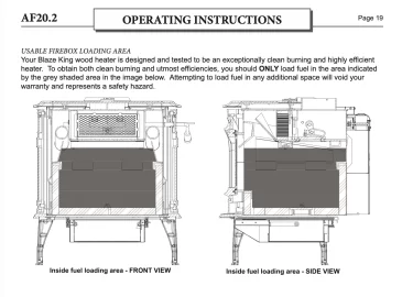

You also want to look at the diagram towards the beginning of the manual that shows the usable space in the firebox shaded in gray. It took me a few tries to understand this diagram in relation to the actual stove. My understanding is that wood should go no higher than the flame guard, even if there's space to wedge wood into the upper sides.
Reactions: msnell
Thanks for the reminder this was in manual. Though it seems like if you're loading N/S this "usable" area is pretty much as much as you could pack in anyways. It looks like the only area you could maybe go above that is putting something up front E/W and way up high in front of the cat.

interesting, those angled side shields are absent in my (30.2 model) stove. I can have my splits touch the big air tubes in the top left and right because the shields up there are parallel to the vertical wall of the stove.
Ah, I have Ashford 25 insert, and the air tubes aren't shown in the diagram. My reading of *my* diagram is that wood shouldn't be placed directly in contact with the air supply tubes, which took me a minute to realize (and appears consistent with the placement of the shields shown for the Ashford 20).
