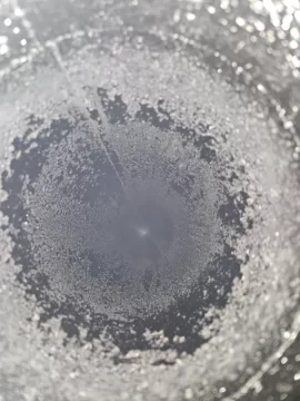

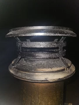

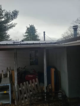

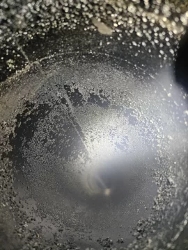

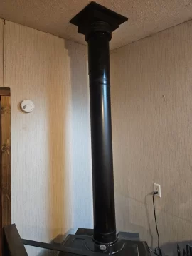

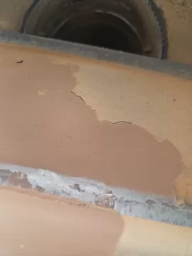

Hey All,​
Anyone in here very familiar with cat stoves, particularly blaze kings?
Ive had two small chimney fires and I'm terrified of this thing. I clean the chimney once a month. Its a double wall pipe to double wall stainless. Roughly 16 feet straight up. I remove the inside pipe and clean above the bypass too.
Wood is all hardwood, under 20% moisture per my meter. It seems to happen when I drop out of the active zone and reload when it's still warm. Cat is old but still working well, new door gasket. Bypass gasket is in need of replacement but isn't bad enough its not functional.
I reload by opening the air and the bypass, waiting a minute, slowly opening the door, filling the box, and leaving the bypass open until it reaches active again.
However, before it reaches active again I get loud crinkling noises from the chimney. I walked outside, saw white smoke, heard two pops, and saw a splash of orange at the chimney cap. I shut the bypass and air. It settled down and the I kept bypass shut and turned the air back up to get it burning and it worked completely fine.
Again this morning from cold startup, I put a few pieces of wood in the stove and lit it. Before going active, I got the creosote burning smell and crinkling in the chimney. I took some photos. This can't keep happening or I'm going to burn my house down. I'm terrified of this stove. The installer wants 265/hr from the time they leave their shop over half an hour away and until they get back to talk to me. Please help.
I have a 3 year old and two dogs. I need some advice on this thing if possible.

Cat still stays active long term. It doesnt have trouble keeping temp, but I did just talk to blaze king on the phone and I think they're going to warranty the cat. Maybe that was the problem?
I'm curious if the black glazing of creosote is normal in the flue. Should I be concerned with trying to have that removed? I'm not sure this is a cat issue because it occurs when the cat is bypassed.
The issue is glazed creosote.
In bypassed mode, flame enters the flue and starts burning that creosote. Aka a chimney fire.
You are depositing creosote and that is either because your cat is not doing its thing or because the wood is too wet.

How do I clean the glaze? Totally new pipe?

At that age, I suspect the cat.

I plan on replacing the cat, the thermometer, and the bypass gasket.
My main concern at this point is do I need new pipes? How do I remove the glazed creosote? I don't want to continue feeling unsafe burning wood to heat my house.

1. Warranty the CAT. If not purchase a new one. Small cost for updating a consumable. Also eliminate one point of possible worry.

Regarding the flue, glazed creosote will likely need a professional (with chemicals) to remove.

Again, I think my biggest issue is removing the glaze of creosote. I Just brush the chimney. I've called several sweeps, one of which did nothing and took 275 dollars. others are not taking new clients or are not returning my calls.

Would I see improvement if I just replace the bottom 4 feet, the interior double wall stove pipe, with new? There would still be creosote in the class a pipe.

How tall is your flue? Too much draft can suck the gases thru the cat too fast for the cat to combust everything.

Roughly 16 feet straight.
ok. That's not an issue then.
To sum up, having glazed creosote needs
- smoke particles in the flue (so either a cat that does not work well, is overwhelmed by too much "cat food" due to wet wood, or one where the gases flow too fast - the latter is not likely here)
- water. That's always present in combustion products, but gets more fast when wood is wetter.
- a cool flue; below 212 F water condenses, capturing smoke particles, leading to creosote deposits.
If the cat is good and the wood is dry enough, one would not expect sufficient particles to be in the flue for such creosote deposits.
Yet, even when that is not good enough, one can minimize deposits by keeping the flue hot enough (all the way to the top) so that water does not condense.
