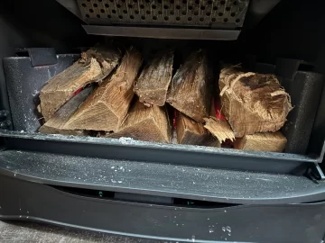

Post a pic of the load you put in the stove next round. Prior to lighting.
Thanks for responding. this is how it looks this morning.
Loaded the insert 11pm last night. At 8am this morning nice coal in the stove, the needle is still in red zone.
I load the insert 8am. Pic1

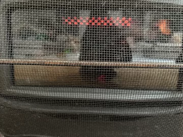

Went to get ready for work and had some breakfast. Temperature setting at highest level and bypass open to get the fire going, roughly 20 mins Pic2

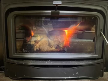

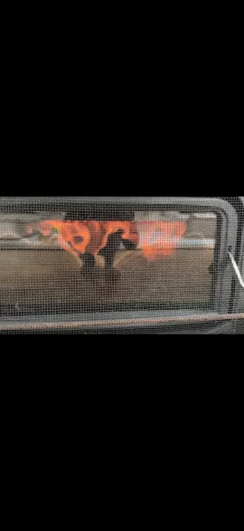

Closed the bypass and turned down the temperature setting to lowest, left for work. Asked wife to take a picture around 9:40AM. The cat is glowing, and you can also see the fire roaring Pic3&4 (apologize for the pic quality)

Soooo. Normally closing the bypass and immediately reducing the temperature setting can risk stalling the cat.
The BK recommended approach is to engage the bypass as soon as possible/gauge indicated.
Burn at a high rate for 15-30 minutes.
Then reduce temp setting to your desired burn rate/output level. Sometimes doing a few adjustments on the way down.
Another tidbit for consideration. On every BK install the effective/useable amount of therm knob movement may be much, much less than what is available.
Wide open is the same position for everyone.
Your stove's "low set point" may be a completely different knob position than the next BK owner.
Many (not all) find that all effective adjustability occurs from wide open back down to the halfway point or somewhat less. All dependent on variable's like venting length and install location (main floor vs. basement), dwelling elevation, current weather etc.
In a nutshell your therm knob can make a 180 degree swing. It would be common to only use 90 degrees (+,-) of that adjustment range for complete stove control.
Food for thought.
Don't fear filling in the left over space above your pictured load with more splits. Stuff it.
To get the advertised performance.
My experience and opinion only! Enjoy your learning curve.
Your piece size creates tremendous surface area. More surface area = shorter burn times & more flame activity. Also, your load isn't a "full" load. Grab some much larger diameter pieces first, then, use the smaller pieces and play wood stoves metric!
Otherwise, your burn times and rolling flames are normal...especially in the first 30 minutes or more after closing the bypass.
BKVP
Very good point. Thank you. Stacking the wood to fill up the firebox seems simple but definitely need to be creative.

Also make certain the bypass is closing completely.
