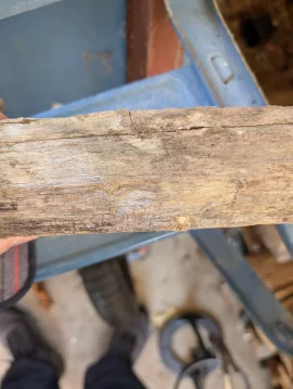

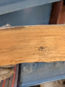

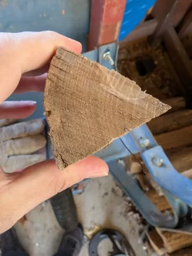

Ok - so here's the update. I tested the wood and I think it's dry enough. I followed your advice and tested 4 pieces that were freshly split. Each one registered in the 12-18 range. To double check, I split a piece that I had cut about 2 months ago and it registered in the low 30s. I used the soft wood setting - because when I used the hard wood setting everything was registering at like 10 - even the piece that was in the low 30s registered at 12. I thought I had hardwood - but again being new to this I'm not sure what kind of wood it actually is. I'll pose some photos - but not sure how helpful that would be.
In good news - I followed some advice from this thread and tried a different fire set up. The manual said to make a fire with kindling and then add 2 logs but it wasn't really working for me. I use a log cabin style set up with several pieces of kindling and 4 logs. I also followed the advice from people and opened a window up a bit. The fire turned out MUCH better - but not so out of control as the one on my original post.
I'm not sure if the catalyst engaged or not. It never turned red, but I was purposely trying to keep a small fire going to follow the manual recommendations of making small, slow burning fires the first 3-4 times you use the stove (although with as much heat and smoke and smell as came out on my original post the curing might be done already. The temperature gauge has stayed just inside the red active zone for a few hours now and I'm seeing very little smoke coming out of the chimney - but with it never turning red I'm not sure if it's working or not.
Thanks again to everyone for all the help!
Sooooooo? You physically re-split these pieces yourself just prior to testing?

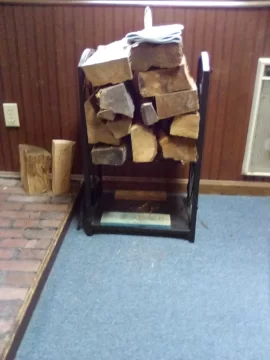

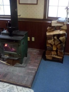

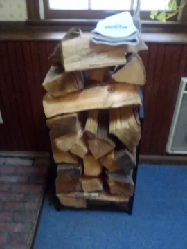

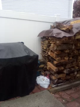

Thank you for that! I definitely had my best fire so far after I put the wood inside the day before burning. Not sure that made a difference in moisture but putting wood that wasn't cold from the start in seems to help. Thanks again!
Reactions: Burnin Since 1991
If you have the room, try to keep a couple days worth of wood in the house. The warmth and lower humidity makes the wood burn better IMHO. I have no data or evidence to back that up, however.
It's a double rack, with a top and bottom level. The bottom of the rack moves to the top when the top is low. Then we reload the bottom again. In shoulder season, the top can be 3-5 days worth and the bottom 1-2 days. My intermediate stack is 4 steps out my backdoor, which is handy when there is a foot of snow on the ground.
The wood in the rack is more than 18" from the stove per manufacturers requirements. The last pic shows the bottom empty, moved up top and awaiting restocking. Since it's a small rack, during the heating season, I may need to restock that every other day or every day in extreme weather.
