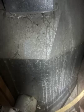

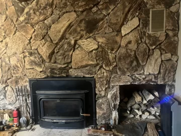

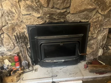

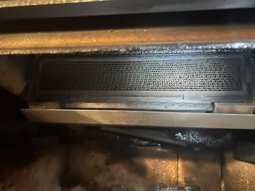

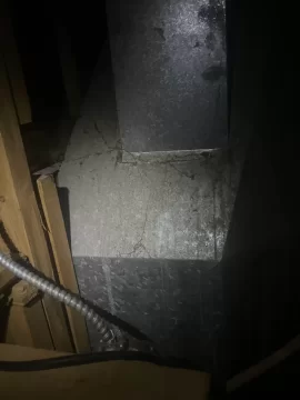

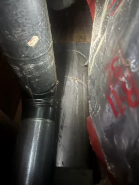

I don’t want to say all is fixed.. but I will say, I decided to run the brush up through the chimney to be sure, and got close to a 5 gal bucket of soot and creosote out.. I’m thinking that when it was cleaned, they may have only went so far and hit a block and stopped, thinking it was the cap.. I have her ripping to an extent it hadn’t since last year. Went about an hour full bore, and has been thoroughly in the active zone for the cat so running there for now, slowly bringing temp setting down too. Photos below are before cleaning today and inside the wall cavity and cat at this point. Stay tuned. Hoping to keep this momentum. Also started with newspaper, fatwood, and a package of kiln dried to be sure it was ripping. Testing my splits this week for MC as I get more time.

5 gallons is a huge amount of soot and sote. The sweep needs to refund you. That is not in any way acceptable and could have been dangerous.
View attachment 342567View attachment 342568View attachment 342569View attachment 342570View attachment 342571View attachment 342572
That install is very concerning
Reactions: moresnow
Ok point me in the right direction to learn why
Because its an insert in an old prefab fireplace of unknown condition thst looks like it wasn't installed with proper clearance to begin with. That never allowed inserts to be installed in it. Its unknown if it has cooling channels that have ben covered up.
Idk if it helps or hurts the situation but there are two. See the red lines. With in line fans at the bottoms of each line that I can turn on and off
  • [Hearth.com] Ashford 25 Insert with existing ZC fireplace
There are just to many unknowns. It may be perfectly safe but you are combining 2 systems that were never meant to be used together so I have no clue. Even if I was on site allot of it would be guessing because nothing has been tested
