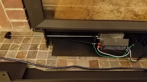

Picture of the whole thermostat housing, you can see how it is up against the bottom of the firebox.
[Hearth.com] Ashford 25 Insert - New Install/Operating Concerns
The thermostat will close based on heat from above in the firebox, it will only close so much when cold. It is slow to react but based on input of heat it will gradually close the flap, it is intentionally slow so it can moderate air intake in a controlled fashion.
I didn't have any issues with it closing while running with the cover off but I am sure it might have throw it off a bit to be exposed to more air than it was designed for. All that heat from the insert above gets transferred to the thermostat housing which in turn opens or closes the bimetallic coil for the air flapper.
Thanks, I’m able to completely shut my flapper closed with the knob on a cold or running stove. I was curious if that was normal or not. My stove has a factory uncovered flapper. But I see the silver box behind it must grab it’s heat from the firebox above it. It seems strange to grab heat from something that’s insulated by a bed of ashes and firebrick.
Below is what mine looks like with the front ash lip/valance removed.
  • [Hearth.com] Ashford 25 Insert - New Install/Operating Concerns
I believe everyone can close the flapper fully even when cold.
Reactions: BKVP
Thats what I always thought. However I read in the Mellow's link from 2016 where BKVP, stated: "the blade should be at a 20 degree angle when the unit is room temp and thermostat knob is set to lowest setting". I realize thats on a 10 year old product and things have probably changed.
Folks (incl. me) can hear the flapper close. The position of the dial when it closes will change with temperature (because the coil spirals).
I don't know if you have a stop preventing from closing to get the EPA minimum of air flow. Other models have a hole in the flapper for that (so closing it makes it seated on the opening and the hole allows the air flow).
My flapper has no hole, it’s solid on both halves. So when it’s turned all of the way down, it’s like a closed door.
