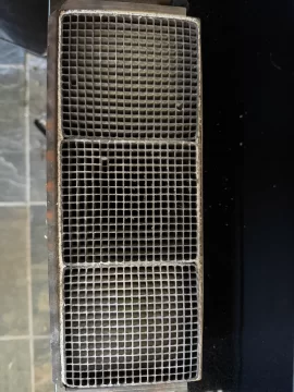

As an aside, How does this cat look for 2 winters usage? No visible cracks or any apparent damage. Seems OK to me. TIA

Tough to tell by looking at it but no major cracks or crumbling, I think you can see the wash coat separate (peel) but other than that lifespan is based on performance during the burn.
How does your stove connect to chimney, can you get a telescoping pipe to pull vs pulling the cat to clean its chamber?
Not sure if that's wash coat peeling, or ash/burned deposits on the cat.
Doesn't look bad to me.

You can't tell that a cat is good by looking at it. You can definitely tell if it's bad due to physical destruction. They just wear out and stop working.
