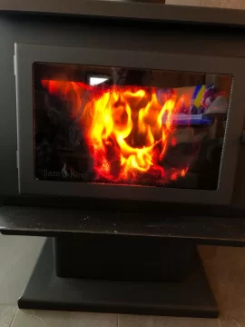

Hello everyone, I’m new to this and looking for some help/advice. I’ve read everything I can find on Blaze King stoves and it seems like I’m the only person having trouble controlling my stove. It’s uncontrollable. If I turn the thermostat up a hair the gauge on top pegs out pointing toward 5 or 6 o’clock. So I have been running it in low(I turn it down until I hear the little flap close) then I turn the dial up a hair and the gauge goes all the way up again forcing me to turn it back down. It’s driving me absolutely insane because this is our main heat source and I’m having to keep an eye on it 24/7. I’ve burned about 1 cord maybe a bit more through it so far.
I’ve talked to Blaze king and they were not able to provide any information to help. I spoke to the company I purchased the stove from and they said “this is a first” and couldn’t provide any help.
Stove - brand new stove, brand new chimney, 15’ straight up, double wall into class A through the ceiling and on the roof. Terminates 3’ above ridge.
Wood - all hard wood stored in my basement reading 12-14% on a fresh split. I would consider the splits to be medium in size. I’ve already tried loading with the largest logs I could find and it does the exact same thing.
I’ve tested the door gasket and it’s tight all the way around.
Relighting the fire while still in active zone. I disengage the cat damper, turn the thermostat to high, open the door, fill the box full, close the door, let it rip for like 5 minutes, close damper door and lock, start turning down the thermostat or it will climb to the 6 o’clock position on the gauge. I always turn it down when it points toward the word active on the gauge. I’ve tried turning it down slowly. It doesn’t help.
I have a call into our chimney guy to come out and add a 3’ section of pipe to the top to give me 18’ total. I’m at a loss of what to do so this is the last thing I can think of.
Please HELP!

Just the cat temperature. No or very little visible flames during the temperature increase. I do have an ir gun. What temps should I be looking for on the stove top? Or what temp is too hot?
Wont increasing the chimney height reduce the draft? I feel like too much draft is the biggest issue here.
I read about new cats being the cause of this problem but it’s been 4 weeks of consistent burning with zero improvement.

I have a brand new Princess 32. My CAT thermometer also pins to the 6 o’clock position, totally normal. You let her rip for 5 minutes, I let mine rip for 20 minutes to help clean the glass and get the stovepipe and chimney hot. After 20 minutes I’ll start turning it down in 2 increments over 10 minutes or so. My stove appears to be running uncontrollably at the 20 minute mark with the thermostat opened to full. Needle still pinned to the 6 o’clock position. As you restrict incoming air the needle will SLOWLY swing away from the 6 o’clock position.
I have about 13’ of chimney and burn Jack Pine at 15% moisture content.
What you’ve described as uncontrollably sounds normal to. The fire in my stove completely fills the entire window when running on high for 20 minutes.

Tall flue increases draft. Above the cat expect to see 600/700 degrees until things settle in. Rest of the stovetop 3-400. Expect a hyper cat a little longer. If thermostat wasn’t doing its job you would have active flame. Sounds like you have perfectly seasoned firewood!
Also expect cat temps to INCREASE when stat is turned down. Seems backwards but the chemical reaction with the smoke in the cat causes it.

I really appreciate all the information you provided. I kept thinking I needed to keep the needle on the gauge from going past the end of the “arrow” in the active zone. If this is the case I’m probably burning really low and should have the temp turned up quite a bit. See the picture below. I would start to panic a bit when the temperature would reach this area. I bought the other temp gauge just to see what the temperature actually was. I’ll check the chimney as well. Thanks!

Thank you! So directly behind the cat thermometer and in front of the of the flue is reading about 450 degrees on my ir.

@Clmillard97 I agree with what was said before, only pay attention to the cat thermometer on startup, otherwise ignore it.
I'm not surprised the cat temperature takes off when you turn down the stove, because that dials down the flames, leaving the wood smoking and delivering more fuel for the cat.
What's really helpful is a flue gas thermometer, such as this one. You'll need to drill a 1/4" hole through both pipes to reach the inside of the double-walled pipe, and obviously need to remember to remove it before you sweep. Place it about 3' above the stove top.
That'll let you keep an eye on flue temperatures, especially on startup with the bypass open they can really take off. I usually close the bypass and dial down the thermostat once that reaches 900F to prevent damage to the flue.
That said, when running the stove low and slow, I oftentimes see flue temperatures only in the 200F range. That would create lots of creosote on a normal stove, but the BK's are not normal. Due to the cat, a lot of compounds that create creosote are combusted, and I only get a cup or two full of dry creosote when I sweep once a year.
