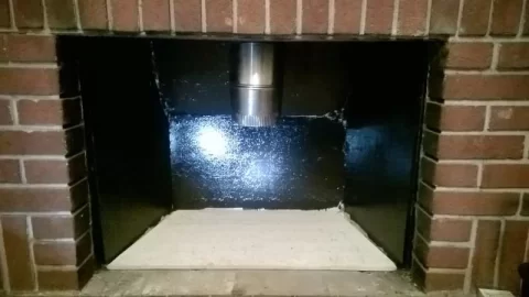

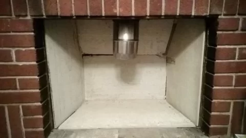

After seeing the gains from just the back piece of cement board I have gone ahead and done it properly on back,side,bottom,top.
Just about finished:
Finished and painted with high temp black paint in case I decide to run with no surround:
Will let you guys know how it does.
Did you go with just the Durock? I'm not seeing the Roxul. I'm keeping close tabs on your project : )

Loaded the insert last night at 9pm, came down this morning at 8am to the cats still purring along at 1000 degrees and the downstairs at 73, had a low of 25 overnight so I think it is safe to say the updated insulated fireplace with Roxul and cement board IS helping to keep the heat in the firebox resulting in even longer burns.
My block off plate is half inch Durock with a layer of Roxul on top of that. The side cement boards do not have Roxul behind them, the back has Durock and Roxul behind it. The insert does sit on top of half inch cement board now.
The addition of cement boards also helps to block out the fibers from the Roxul as a bonus.
My next upgrade will be when I redo my hearth I will get some sheets of Micore, I will upgrade the Durock to Micore for better R value.
