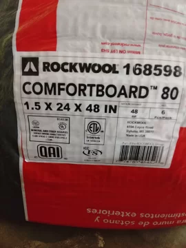

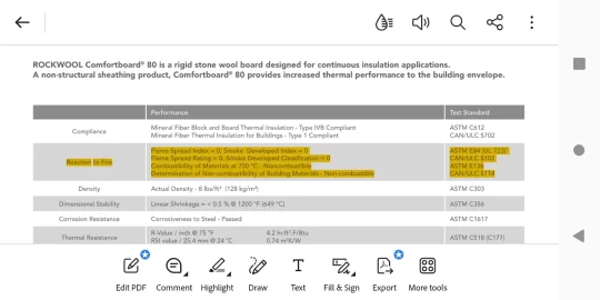

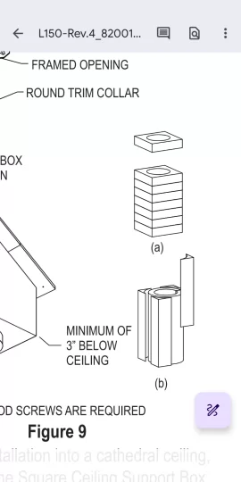

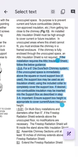

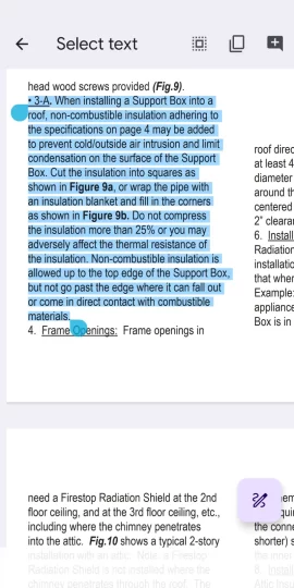

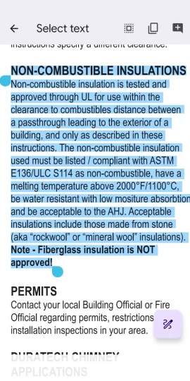

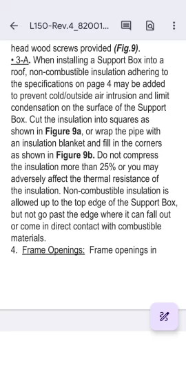

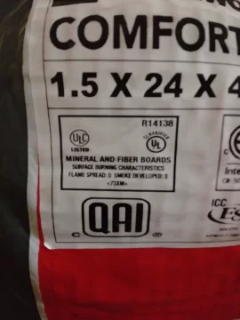

I am currently working on my chimney install and stove at the moment and DuraVent for DuraTech chimney pipe states in regards to insulation in the support box it must meet certain codes and you must not compress it by more than 25% due to effectiveness on ratings.
Rockwool Comfortboard 80 does meet the criteria. See attached photos.
Also you MAY extend the support box to the roof sheathing by building an enclosed chase (DuraVent states)or extend the support box with sheet metal of similar thickness (according to my local installer, area dependent).
That is great information, thank you for that. I ended up using 2200 degree rated ceramic insulation like you would use in a forge. I lined the sides and the bottom of the support box. I then created a "seal" for the top out of a square piece with a hole cut out, like the picture shows. I air sealed the support box pretty well too. Used high temp foil tape to seal all holes and the edge where it meets the framing. I feel pretty good about it. Good luck on your install!
