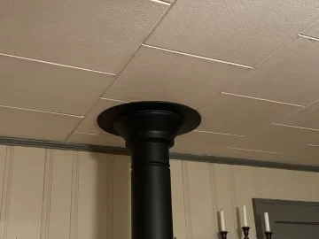

Mines not the same brand, but I had to frame it in between the joists, since the spacing was wider than the box, and added cross braces between the joists. I also added the insulation shield to keep any debris or anything a mouse might move around off the pipe.
[Hearth.com] Ceiling Support Box: question about box height[Hearth.com] Ceiling Support Box: question about box height[Hearth.com] Ceiling Support Box: question about box height
It’s been this way for almost 10 years, but I’m gonna add another brace where the roof penetration is sometime this summer.
When I sweep I have to pull the top piece of class A off and sometimes the pieces below it spin from the attic when I’m trying to unlock the top pice on the roof. This should keep everything below the roof from spinning, and keep some of the weight off the ceiling box.

Good illustration. That's proper. I would also seal up the 1/4" gaps with silicone caulk or wood strips so that no dust can get into the clean space around the chimney pipe. This would be important if blown in insulation was used around the shield.
