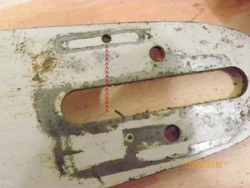

I did as you all advised to fix my lack of bar oil problem. I removed the side panel. I fired it up and oil came out of the hole above the posts. So I cleaned up the bar. That was the big issue. The bar was filled with crud. Cleaned it up really good.
Dumped the oil and checked the intake. I thinned the oil down some for better flow.
I would like to adjust the flow with the nut on the bottom - but I will need to buy some torx sockets. The flow still isn't what I am used to, but the chain did have oil now and spit a few sprinkles onto some paper for me. A far cry from the oil my ECHO throws. Is this what I should expect with a Stihl or should I continue to work on getting more oil from it. I've still not run her much - just tinkering as the snow is falling. Once I get a torx socket - I'll try and adjust the flow with the nut on the bottom.

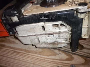

basswidow here are two pictures, one of the bar and one of the oil quantity control which is adjusted by a screw at the bottom of the hole.
On the bar did you clean out the small oil hole?

I just crank it up. You will not miss a little oil, you will miss the bar.
The 290 uses a small straight flat head screwdriver to adjust the oil flow. Same driver you use to adjust the jets. Believe it or not, I was overoiling my 20" bar when I was running the saw hard this fall. As the oil heats up the bar oil thins. An air compressor is a great thing to keep the bar groove and oil holes clean.
When stuck in the woods and needing to adjust the oiler I have used a broken off clip from a pen.
Zap and others: thanks for the tips. The bottom on mine is scratched up and I totally missed that oil adjustment hole. Now I found it.

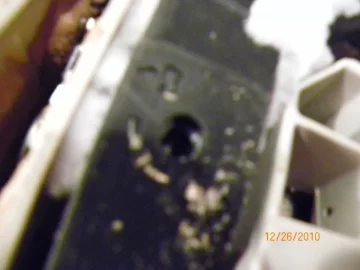

I don't have one of those long flat adjustment screw drivers. I'll have to get one. I cleaned the gunk out of the hole and shined a flash light down in the hole and I swear - I don't even see a screw head. Maybe it's really deep?

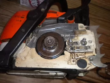

Take a look at my saw and see if it looks like any parts are missing under the side plate? I removed the bar and chain. This is the oil port that I cleaned and also cleaned the bar. I'll need to adjust the screw once I get the proper driver. Just want to make sure nothing is missing - since I bought it used and have never seen one before.
I cleaned the air filter today and switched the tab from summer to winter operation. Near the carb - there appears to be a vent hose for the gas tank? I should switch the gas and oil pick ups and change the old filter too. I am planning on pulling the muffler apart too and checking the screen.

From the pic your just missing the side cover...lol j/k Looks good
I'm not sure how deep that screw head could be, if Highbeam used a broken off pen clip to turn the screw... Also, that chain catcher is a really important safety device.
It's much different looking under the side cover then what I am used too. Thanks for giving it a look over. I will have to look for a chain catcher to put on.
I guess it's possible that the oil adjustment screw could be missing? Maybe I should just take it to a Stihl Service center? Once I get the flat driver that will fit - It should be fairly obvious if the screw is missing.

In the first pic above oil port there is a chain guide...There should be one under the chain adjuster as well...
The chain catcher is aluminum and will bolt on using the bottom felling spike bolt....

The screw for the oiler IIRC is brass and is pretty far in there. Like an inch or so, the pen clips are 2" long. The driver is nothing special, just a small flat head screwdriver. Max oil flow is clockwise as I recall and since not many folks try and reduce the oil flow from a 290 I am betting the screw is still in there.
A little odd seeing the bumpers and catch missing. Makes you wonder why, like what did they take the saw apart for?
