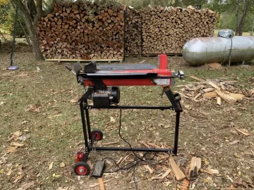

I made it to to fit my stihl 029 super with an 18” bar and my stihl 180 with a 16” bar. I built a fair amount of adjustability into it so it'll probably fit others. It is hinged - just remove one wing nut and the saw will rotate onto its side for adding oil and gas. I made it to fit an electric log splitter stand, which is Boss brand but I use my harbor freight electric 5ton splitter (identical to the Boss and others). Since then I've bought a second stand so I don't have to switch them around. You can snap a bucket on the end and it will catch most of the sawdust. It has an adjustable wood length gauge.
There's some pics and video below. The video looks like I'm closer to the bar than I am because of angle. Im actually a safe distance from it.
I saw various versions on youtube and used features I liked from different ones to come up with how I wanted mine. This was made with scrap 1x4 tubing a friend had given me from a crate years ago, some other scrap I had, a few metal pieces from lowes and various hardware. I used a small angle grinder with cut off wheels for the cutting and a 110v northern tool klutch brand welder.

I went with a bar and linkage instead of a foot pedal as I walk the limbs in to be cut. So the limb itself activates the throttle. I did replace the momentary switch on my harbor freight elect splitter with an on/off switch and added a foot pedal (pic below).
