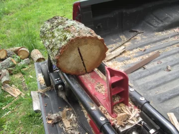

I have The Boss 7 ton electric splitter. $800 at Home Depot. Great little machine you just turn it on and it runs, it is a one hand operation. If I have a big piece that will be difficult to split I make a 3 inch deep chainsaw cut on the end and split into that cut. Then it splits easily and doesn't blow apart.

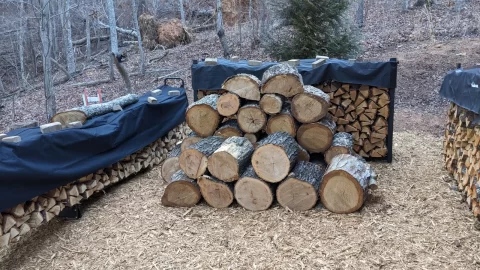

We bought this splitter. When hurricane Helene came through there was so many trees down. We didn’t want to spend a ton of money. We split lots of big stuff on it and I have to say I was shocked it handled it. My son attached a foot pedal(not spliced in) to it for operation. He used a clamp that holds the button down. I included picture of the size of the wood we were splitting.

vatmark you're splitting those oak drums without having to make a chainsaw cut in the end first?
If so that WEN is outperforming my 7 ton Boss, and it is a lot cheaper. The Boss is a great little splitter don't get me wrong.

It was me(the mom) and my son who worked together. We never used a chainsaw to cut the ends. But I will remember that for the future. We first looked if there was anything that looked like a natural split and started there. If that didnt work we rotated the round and eventually found a spot that worked. I have to say I was pretty shocked how well it worked. Sometimes we had to have the round “not centered” so the split was going through closer to the side of the round. There were a few rounds that we used a wedge and sledge hammer to split in half first because they were just too big but it was only a few out of all we split. We filled a 12 foot rack, 8ft, 10 ft and 5 ft using that splitter. I just looked and we paid $281.05 with tax for the splitter.
