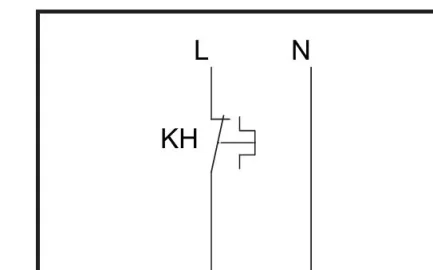

page 7 has a typical electrical layout. KH is an overload with a reset red arrow. It is very confusing to me how it works but if the green arrow points to a switch that would make sense. It is a permanent capacitor start/run motor. It's possible the cap is bad if the pump is good
Edit - not sure how this works - do you press the start button to split (operates the ram) then release the start button? Anyway, if it humms I'd look at uncoupling the pump and retesting

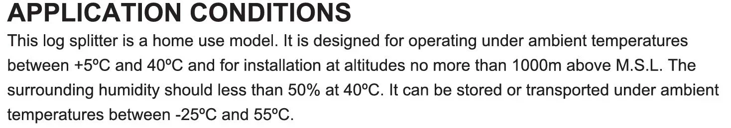

"The green arrow leads to the start button and the red arrow leads to the button that IS NOT described in the directions."
That is the overload relay with a reset (KH). Note the operating temps.
