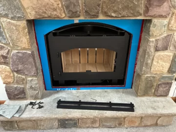

Advice on a fireplace surround - can I go with aluminum? Here’s a picture of my brand new Heatilator PioneerII fireplace which the dealer successfully fitted into a stone facade that once held a 35 year old Marco unit. If you’re wondering about the blue color, that’s a surround template that I made using sheet plastic from the nearby Amish junkyard.
What I did in the past with a Lopi Cape Cod insert fitted into a true brick fireplace was to just drop off a template at a metal shop and pay what the they asked for 1/8” steel cut to my template. The price was north of $400 and that was ten years ago.
The very same Amish scrapyard has a pile of 1/8” aluminum sheets available at scrap price. The sheets would be more than big enough. I’ve already bought two for other projects and they cut easily with a saber saw.
My question is: would aluminum work? There’s a lot of discussion about surround panels on this website and folks even glue them on with high temp silicone. Now, if high temp silicone will hold up aluminum certainly ought to. I’m not aware of any silicone RTV rated over 600 deg F and aluminum is twice that.
No, it’s not steel and the Amish scrapyard does have hunks of sheet steel around but it’s a bear to cut with a saber saw.
Opinions, please.

I would use the scrap steel & cut it using a grinder with a thin abrasive wheel. I have a 20v DeWalt grinder that works very well for cutting metal. 5 AH batteries rock.
I think that I answered my own question. I spent a lot of time Googling and found out that Stoll produces a whole selection of aluminum fireplace surrounds, even generic replacement fire place fronts with glass doors and everything else aluminum. Looking back, I could have just removed the broken Marco doors and their tracks and assuming that the measurements would match up, drilled a couple of holes for sheet metal screws and put a Stoll replacement facade on.
Actually, I’m glad that I didn’t. It cost me $10,000 all in considering that the wooden chase was rotten too but I now have a state of the art Heat N’ Glo/Heatilator fireplace with a blower that works and a steel door with glass on the front versus folding broken glass doors. The chimney piping is all new and there’s a new stainless steel cap on the chase so I’m ready for ski season at the house.
So, the surround will be 1/8” sheet aluminum. You never know where the Amish guys come up with this stuff, but they demolish old factories and buy up old machine shop equipment and stuff it all in rows of old shipping containers except for what won’t fit like I beams which sit in the rain. It’s an amazing place.
