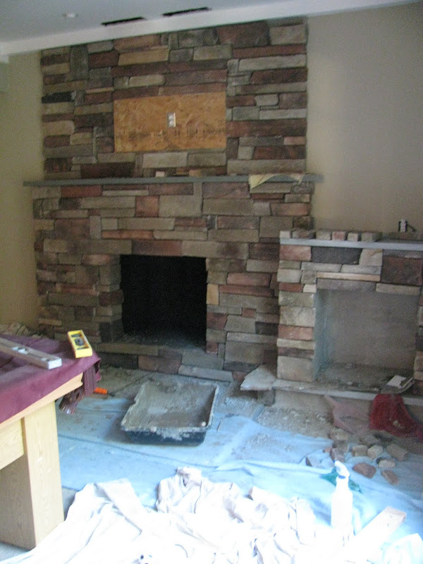

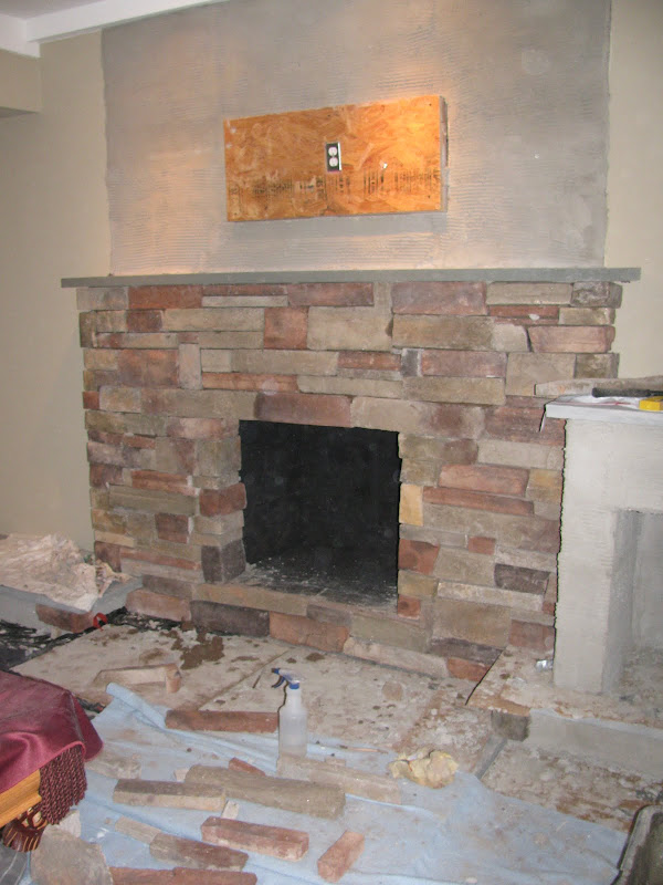

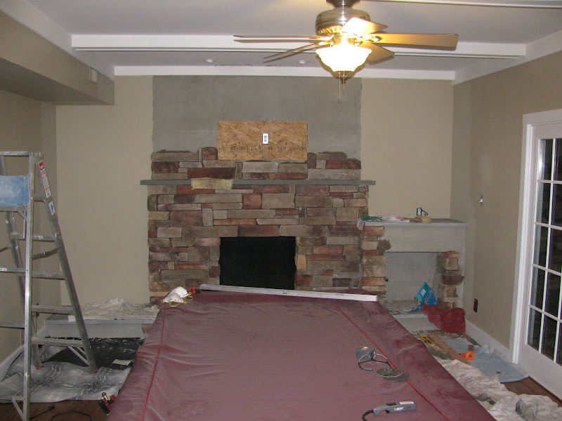

I took the cabinets/shelves out this week and there is no turning back now (I am sure in 10 years I will be saying I wish I had kept them). Yesterday morning ordered the stone veneer. I am doing a ledgestone and I plan on doing a dry stack.
Going 7 feet across and floor to ceiling. Also, taking BG's advice and building the wood holder on the right side (should be fun) and I think it will add a good look.
My question is for the hearth. I am using bluestone. The floor is concrete slab. Do I need anything under the bluestone? I think I really don't need to worry about the R value requirements. Am I correct thinking this?
If I get 2" think bluestone it will be 1/4" above the floor, which I think will be perfect.
The minimum requirements for the hearth are 50 by 55. I am making it 54 deep by 72 wide.
Keep the pics coming as the project goes on. I love seeing these types of things as they progress. I am sure others will as well.
Shawn
Probably no R value needs, if you're setting the stone in mortar check the rating of the mortar - some are approved for hearths and some are not.

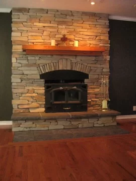

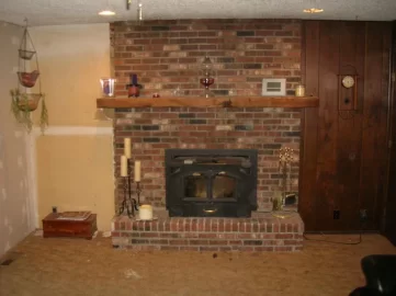

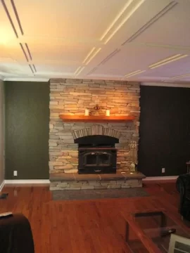

Second, when I did mine, I originally had a mantle which ran the full width of a brick fireplace. I never liked the way it looked...short and stumpy. When I redid it (also dry stacked ledge stone) I made a new mantle which was about 10" shorter on each side compared to the stone - hoping the vertical lines would make the fireplace look taller. Out of the blue the wife says "Wow the fireplace looks a lot better and much taller now" - so I guess that succeeded. Though technically, the fireplace is the same height and actually 4-5 inches wider due to the stone veneer it does look much taller.
Third - practice your drystack first. This was the first thing I'd ever done in stone. When I started, I had the 'cream of the crop' in stones to choose from, so I found ones which fit nice and tight for a good dry stack look. Those ran out pretty quick and I kind of got into the 'misfits' So to keep the pattern looking the same, I had to shave little bits and pieces off of almost EVERY piece. 2-3 hours of careful nipping, tucking, and fitting and I'd have another half foot of stone done...luckily the ceiling is only 8' tall!
The one thing I've changed since was to re-paint the arched steel piece a more stone like color - I thought it looked like the fireplace opening came up and made a mushroom with the steel painted black. Don't have any good pics of that yet, though.

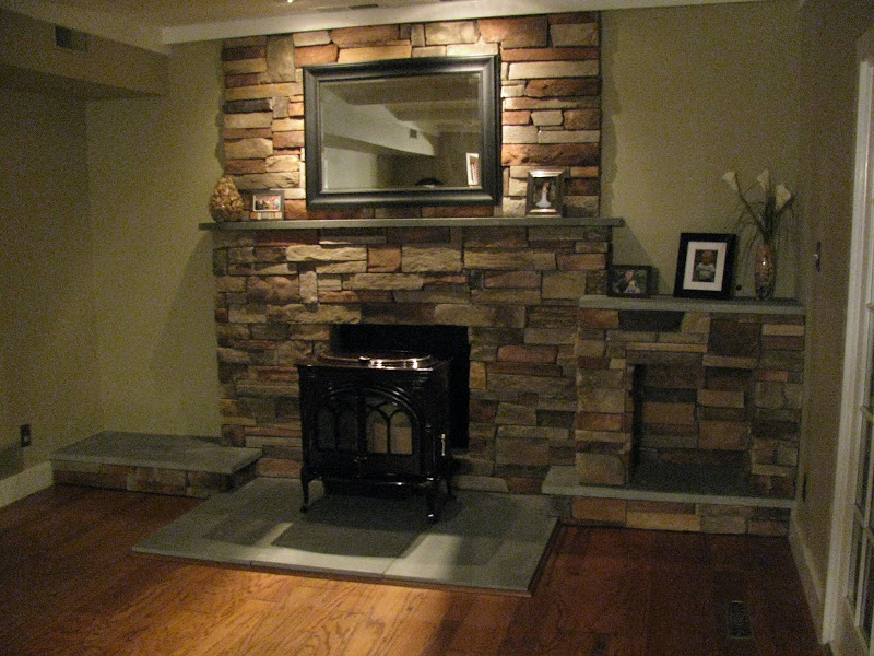

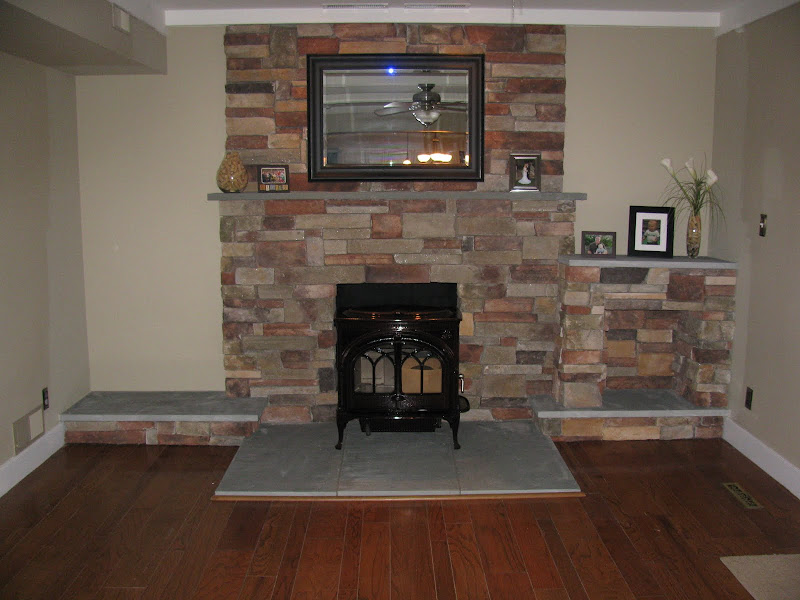

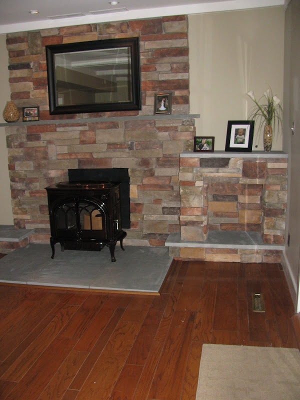

I finally finished the job. All in all took a little over a month and I ( and thankfully the wife is too) am very happy with the outcome. Now I will wait until the fall to install the liner and fire her up.
[Hearth.com] Project finished
Decided to go with a dry stack. Had to cut a lot of stones but happy with outcome

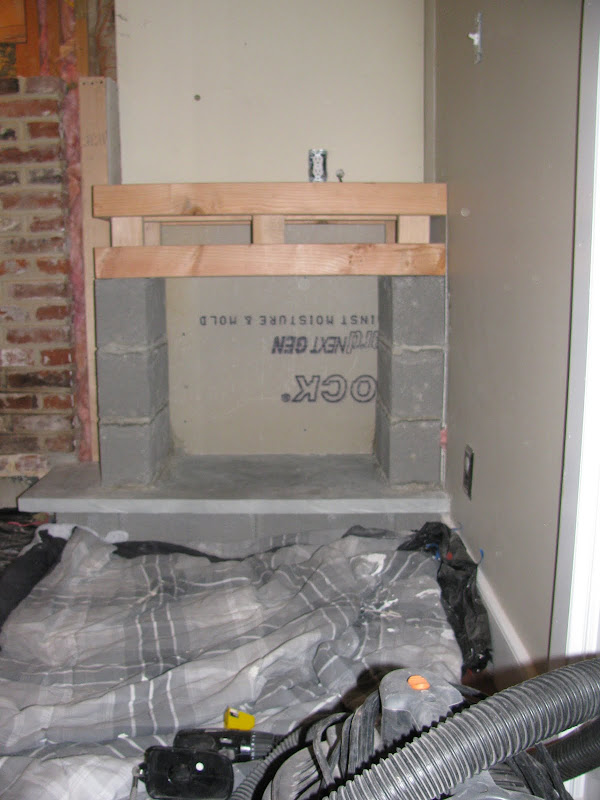

I built a box with and ran electrical and wiring for a TV if we ever decide to put on up there. Also gave something easy to mount the mirror. I built out a little so it was even with stone.
Not sure why but it appears in pictures the mantel on the right side is not symmetrical but it is. It is just annoying in the pics.
BeGreen recommended the wood holder and I thought it was a good idea. A pain the arse but I think it will be great. It is 20 inches deep, about 30 wide and 28 high.
Everything is within clearances and I can't wait for next winter to see how she performs.
I also had to cut the bluestone for above wood holder and the mantel. The width of the mantel is 92 inches with 2.5 inch overlap on either side.
