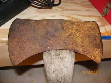

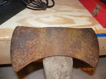

Some pictures of the double bit.

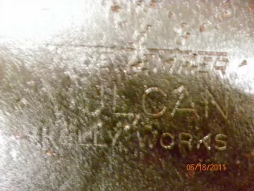

True Temper VULCAN Kelly Works. Good maker.Factory at one time was in Charleston,WV.Also made ball pein & cross pein hammers of varying weights plus sledgehammers for blacksmiths,stonemasons & other trades. After WW II became part of American Fork & Hoe,which made heavy duty shovels & related items.

The handle looks really dry... Is it solid? The rust could be removed by soaking it in phosphoric acid. This is a mild product and water soluble, a 12-16 hour soak will eat all the rust down to bare metal. I use this to treat rusty car parts and it works great. The next step would be to sand it with fine sand paper as others have said, then oil it. As for the wood I like to install new handles, but that can be a challenge....
