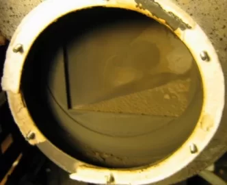

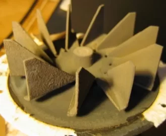

Here's mine after 1 1/2 tons:

Sorry, all, but you're not going to convince me the oil didn't cause the problem. I had already been through all that--did the compressed air, leaf blower, etc. etc. The stove was clean as a bean when I oiled it. My burn problem turned out to be related to the ultra grate having a crack and a missing rod, and also the auger feeding at a higher RPM. There were no clogs of any kind.
As I said, I had taken the motor off multiple times and there wasn't any trace of that stuff until I put the oil in.
I'm not talking about in the combustion chamber. I'm talking about in the housing right where the combustion fan fits in.
I did find one thread that I can't locate now. One guy was arguing that the flash point of the 3-in-1 was too low to be a good oil for this purpose. Based on his argument, it makes sense to me that I had this problem with a stove that was getting way too hot, I'm talking about almost overheating with the auger speed on 1 and the blower on 5. That's hot!
It had been burning that way for about a year. I didn't have that build up on anything until the oil--not on the heat exchanger tubes, or any of the housing. Not until I did the oil.

Think what you may, But burning "Rich" will cause lots of smoke. Smoke and Low exhaust temps. (High Convection Fan, Low heat) will cause Creosote.. Even in a Pellet stove. This has been discussed before. A pellet stove can produce it, although un-likly. It will happen in any Wood burning device when conditions are right.
Go to the Hearth Room Forum and do a Search for Creosote.. Many pics will come up... That is what you have in your stove. Oil does not form Creosote. No woodstove takes oil, but yet under the right condition, they all will produce it.
Please, do not think we are steering you wrong. No one on here wants to give bad advice. No one wants to receive Bad advice.. Everyone does there best to pass along the "Right" thing to do. If your Old Motor had "Oil Ports", then it was supposed to be done at least once a year. Along with a GOOD Cleaning...
Oh and imacman.. My stove has only went a max of 2 tons in between Combustion blower cleanings. Normally do it once mid-season. Just showing the OP a pic of a 3 yr old blower after it had been cleaned.

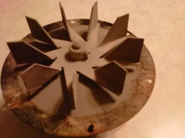

Agreed. And we have compared pics before. Here was the pic I posted when you last posted yours. This is a "Dirty" pic of my blower (For the OP)

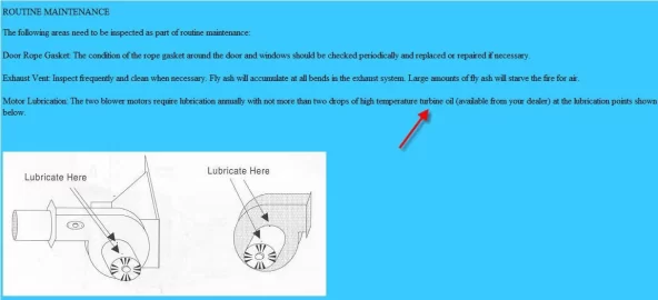

Hello
Well the pic below is from the Whitfield Advantage Plus Operating Manual says to use Turbine Oil.
http://www.butkus.org/whitfield_operate/whitfield_operate.htm
It does say to oil both Combustion and Convection Blowers.
So Snowy's Insulin needle mix should work well.
"What I have in the Syringe is a slight mix of 30Wt and some high temp turbine oil."

All over the fan and the housing was a layer of shiny black stuff. It looked like it would be wet and gooey, but it was totally dry. It definitely had no lubricating properties whatsoever.
I will mention that at the same time, I had a problem with my stove getting really hot due to the auger motor having too high an RPM, so my stove probably got hotter than it should have. Maybe that's why, but it was a total mess. I'll attach some pictures.
So I'll never do that again. I noticed after the fact that they recommend an oil right on the label of the motor. Can't tell you what it is because I replaced the motor and the new one does not require oiling.

That maybe from a bad burning stove, i don't think oil will help that creosote from forming
Definatly creosote. Clean the stove. The video just before this posting shows the same exact combustion setup ,minus housing, as my stove. They definatly need oil. Mine dried out and would not fuction on the lower speeds. I will get tome high temp turbine oil thats to th e previous posts. That is synthetic and definatly high tempeture.
