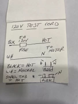

If I were you, I'd make up a 120V 5A test cord and run all your circuits separately.
See which one smokes the fuse! I'm on it!
Reactions: Burnin Since 1991
Fabricted the test whip. All blowers and feed motors function normal. With 48 ohms on the ignitor and it not being shorted to ground I putting my money on the aftermarket board fubar.........
Fabricated test whip all blower and feed motors function test normal. If I were a betting man I putting my money on the aftermarket control board being Fubar.....
