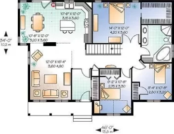

Here is a picture of my house setup. The red dot is where the stove would be located (downstairs) so it gives an idea how it heats.
My wife some times hates the stove because it heats too much. She doesn't like sleeping in a hot bedroom and when it's 24 degree in the bedroom, 23 degrees upstairs and 29 degrees downstairs, she doesn't go to bed with a big smile but I do! :) We end up opening the bedroom window when it's -20 outside!

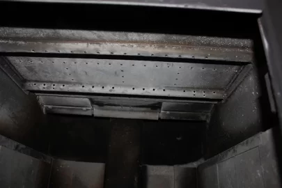

What does the Osburn baffle look like? Is it similar to PE stoves, I know it's stainless. I'd take a good stainless baffle over the ceramic board any day of the week. The bypass is another great feature and if your wife approves of the Osburn I think it should be a done deal. The stove is going to pay for itself eventually anyways.
Swedishchef, could you take a shot of the Osburn baffle and post it?

As requested, here's a picture of the Osburn 2300 baffle. My photography skills are not the greatest, especially at 6 am!
You can tell it's stainless steel and is not removable (from what I can see....)

Wow!.. nice, one thing, the firebricks go 1/2 the way up? - is that what I see?.
Not thinking about it at the time, I had a chance to look at the underside (baffle area) of the Napoleon 1900
but didn't, wonder what that looks like. Oh well, I'm not driving all the way out there again just to find out.
Is there an isulation blanket above or inside the baffle?
I honestly don't have a clue if there was one or not. It was installed last year and I never noticed if there was one. However, I plan on sweeping in the next few weeks and will find out! BUt something tells me that there's none....the baffle is some kind of heat resistant to 2100F type baffle. Then again, there must be one otherwise the stovetop would overheat!
