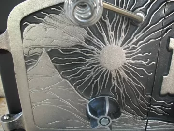

Here's what the rough raised portion looks like compared to the deburred replated doors. Normally the smooth one had the background painted black. This one has not been painted. It would look better with paint, but that's what a new nickled door looks like. Both these stoves are new, out of the box, never fired.
I paid $1025 for the rough one, with original finish, and the polished, replated one is for sale for $1600. Make sure you're not contacting the large Valley Plating in L.A. No idea of their prices. The smaller Valley foundry in Stockton should be cheaper.

Wow, Coaly, they are absolutely gorgeous! The sunburst stands out better against the black background, but I'm not so sure I don't like the solid silver doors better. I definitely like the polished finish.
