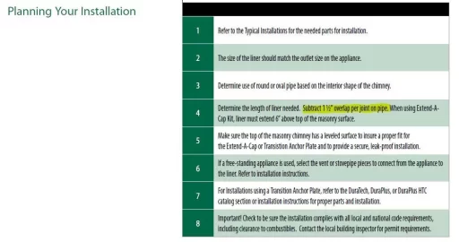

How much does rigid Duraliner overlap when assembled together. In other words, when two 48" sections are assembled together, what's the total finished length, if it's not 96"?
Thanks
According to the Duraliner installation manual you should subtract 1.5" for the overlap on a joint.

Damn. I breezed through the instructions too quickly!
Thanks!
