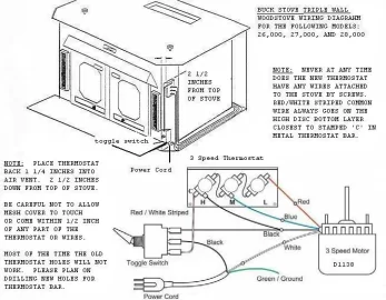

BG has given you a good source for parts. As for the operation, it sounds like you do not have it wired correctly. Here is the wiring diagram.
  • [Hearth.com] Older Buck insert noisy.
