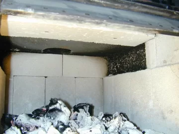

Anyone else noticing groves burnt into your baffle board in the rear ?
I see a little of it forming in the X33. Makes sense that high temp, high velocity air flowing across a fibrous baffle material would form grooves after a while.
My stove is on year 4, and yes there are marks, but they aren't even 1/6 of the way through the baffle.

I'll show you mine if you show me yours
[Hearth.com] Rear tube secondaries burning grooves in 30NC board
Sure it's wear and not just discoloration or buildup of ash making it look like the baffle is wearing away? Mine looks like the face of the moon but in no way is looking as though it's getting ready to blow through w/out me putting the poker through it.
pen
To me it looks like fine ash with a path created by hot air blowing out of the tube manifold holes.. I doubt you will burn that refractory material that stuff can take some wicked heat..

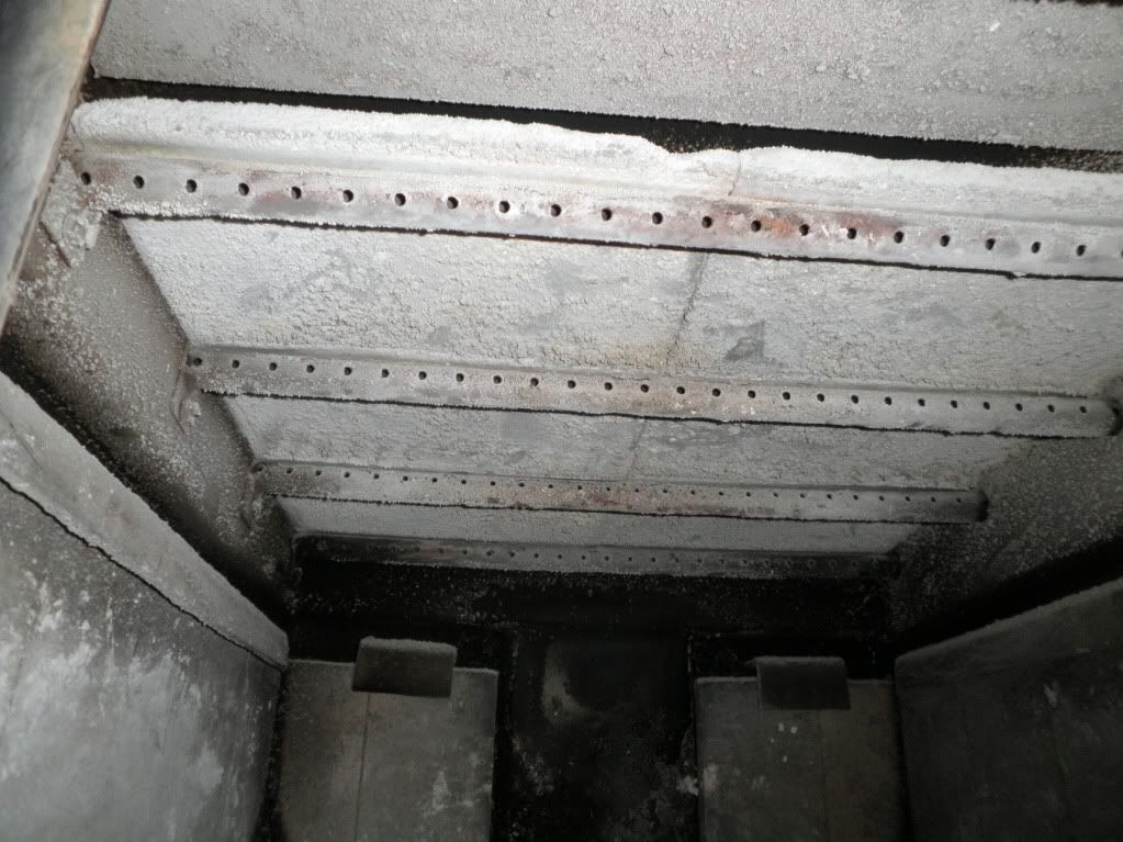

Does the NC-30's have insulation on top of the baffle board? As Pen's pic doesnt show any.
No. Just the boards.
Wow, that's one ugly firebox! :lol:
That FB looks like the ought to to me. He has been burning good wood hot for it to look that way.
Wish I could get a pic of the middle of my baffle boards glowing red hot from the flames licking it and the secondary air finishing off the job.

Just took this snap of the inside of the Kent before I reload it (no sun today so I'm burning...). Clean as a whistle, and with no burn tubes. But then, it has gold-plated firebrick (BG's words, not mine), so it had better be clean!

Hi All
I have done this tubes on a old stove, but now I see there the tubes have all the same amound of holes except front holes are bigger then the behind ones,
I have seen somewhere this is done but a lot more holes in the back, here I see it is different.
Can you guys tell me how wide the firebox is? mine is 52 cm, and the stones are these special, for insulates the fire, I get the hot air not hot enough.
The lower 5 x 5 tube rvs I go set in some extra baffles to get more air kontakt and so heating.
I just need to now how much holes the tubes has, because I see now I did it wrong.
My firebricks are 5 cm thick, and yellow, I do see that the tubes between it do give to much loss to the stones I think and get air not hot enough.(broken image removed)
