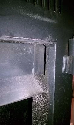

When you open the door look on the inside edge where the door seats...it a square/rectangular cutout on each side of the door jamb....
I have a 2009 and don't see any holes. If I do have it, it doesn't work.
It's the rectangular whole....doesn't work great but it's the airwash system.......
  • [Hearth.com] 25-PDVC air wash
interesting..... learn something new everyday.
