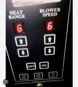

Those motors are 120 volt so if you're only seeing 36 ish it isn't going to work. I would think you're looking at a new board. Is yours the old dial or the newer "touch screen?"

It not a dial but it’s definitely not new. Attached a pic…

Might not be new, but it is "current." I think you're looking at a new one.
