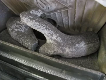

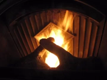

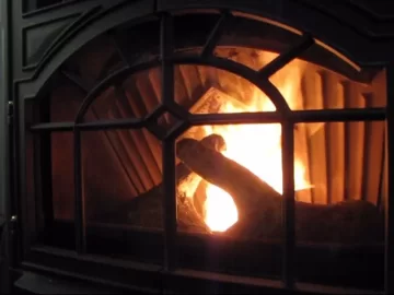

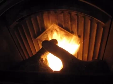

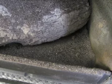

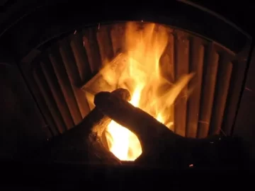

I would love to see some pics of your stove running on +5 also a pic of what it looks like just before you do a cleaning
Okay so here are some pics.I couldn't upload a video so I clipped some images from it. I am running on Greene Teams, the flame height +5 (max) and the stove has been running just long enough to get the convection blower up to max.
[Hearth.com] A couple of MT Vernon AE Questions......[Hearth.com] A couple of MT Vernon AE Questions......[Hearth.com] A couple of MT Vernon AE Questions......[Hearth.com] A couple of MT Vernon AE Questions......
The pictures of ash are two or three days accumulation. I cleaned the window so that you could see, but it wasn't all that dirty. Mostly ash on the right upper side. Ash is light and fluffy.

what setting you on? hardwood?
Yes, I started with utility and move to hardwood when I got the Lignetics. I continued with the hardwood setting when I got the Greene Teams.
Just some comments; I sometimes see flames nearly as large on the +3 setting, just not as consistently. On the +5 setting some of the flames disappear into the down draft section behind the plate.
