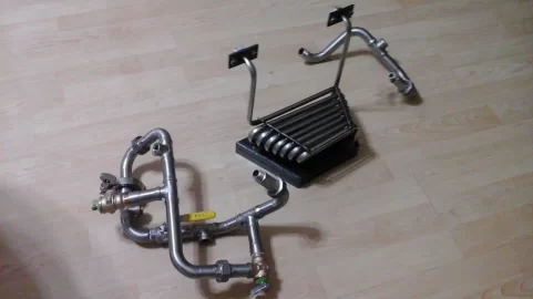

Did you email them to see if they can make a kit for the eco-65, I dont see why not, the pipes could enter/exit right out the front below the door, or go the the side where the air enters the burn pot
I have received it a couple of weeks ago, didn't get time to really
work on it,,and yes it is right out below the front door....
Wow, you never posted it on the board.. please send pics?????????????????????????????????
Here's the component from the kit, it took hours and hours of conversation
and measurements and specs before we were able to create it for the Eco-65.....
[Hearth.com] A few/too many choices????? Not sure
looks real good, wheres the furnace heat exchanger and the pump, what else you need? How many BTU will it support?
Beside the heat exchanger/pump, a 7 gallons storage tank and an expansion tank was needed. Ball valves and copper is also needed
for completing the hook-up. As for the number of BTU, I don't have a number, I figure that for the same temperature since the burn pot fire
will create warm air and hot water to heat exchanger, 2 source of heat for the same fire should require les pellets..

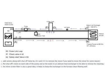

Here's my schematic for my set-up..
Can you just have one bigger one? Are you working this design with crosslink? How can you tie your domestic hot water tank in the system? Will you use Glycol?
not sure it would work with just one,,,Yes I'm working with Tom from Crosslink,,,,some people do tie their hot water, I won't cause I have a tankless water heater,,,,not planning on glycol.
Do you think these fittings would work well with your install?
