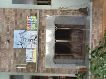

just ordered my accentra insert - install March 12. I was going to run out of firewood for my Jotul so this should help...assuming I find pellets!
Beautiful stove !!
Beautiful stove !!
Very much looking forward to it. 3000 sq ft open concept Cape...have been using Jotul Fireside since 1997 and 6 cords of wood. Looking for less work, to be warmer and still have the Jotul for weekends.
[Hearth.com] Accentra 52i -- more questions on cleaning etc. Here is a before...don't know why it's sideways...
You getting the rail kitt? I didn't need one luckly
Yes, I purchased the slide kit. Unlike a free standing stove, the insert with rails opens the rear for thorough cleaning.
How much did they pop you for the rail kit, if I may ask?
It was part of the package deal from stove, install, piping, $139.
