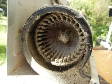

Some canned air and a vacuum is a pellets stoves motors best friends. Could have bought a case of canned air and a nice vacuum for $120:( Last time I looked at a fan for someone for a p series it was $50 from Grainger. I always try to tell anyone bringing home a used stove to go through them and clean everything as the dust bunnies are killers. I use a 2 gallon pancake compressor and a shop vac to do evictions every year and when I did field service. I only replaced one combustion fan motor on a stove since I have owned and used pellets stoves. Heres a picture of an ill stove fan.
