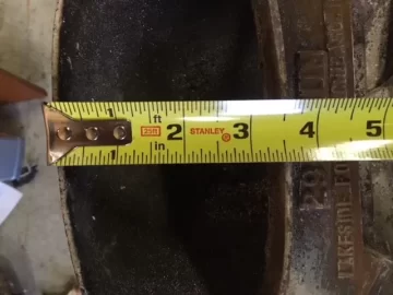

I have been searching for an oval to round adapter for my stove unsuccessfully and wondering if anyone has any advice.
Its an old 1900 era laundry stove. The outlet is about 7.5 x 3.5 inches and my chimney pipe in my garage is 6 inches diameter.
It did also come with the pipe next to it in the picture which fits on the outlet but the top diameter of the pipe with it is 3 inches inches, so I would need a 3 inch to 6 inch conversion piece of stove pipe as well...

I think if you start with a regular two foot long piece of 6" diameter pipe you will be fine.
Assemble the pipe seam so you have a 6x24 cylinder. What you will want as you smush the one end unto an oval is keep the seam in the first piece of pipe on the long side of the ellipse, facing either front or back.
Wear gloves, take your time. If the seam on the pipe starts sliding, tap it back to plumb before you proceed with more smooshing.

Just keep the seam on the flattest part of the curve and you should be fine.
Or you could buy some quality pipe from a hearth store that has a welded seam. I’d be pretty worried about that cheap pipe coming apart if it was ovalized.
