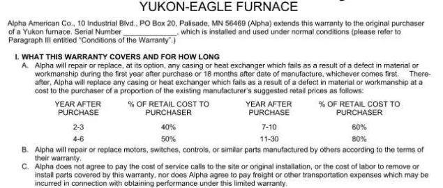

In regard to the Yukon 30 year warranty? Come on, give me a break. It's written just as many other warranties are written for heating appliances. It is pro-rated, not full. After 4 years, it covers less then 50% cost. After 10 years less then 20% of the cost. Also does not cover transportation/shipping, labor, etc. Also is restricted to "if heat exhanger fails due to a defect in materials or worksmanship." That is very open-ended and hard to prove. What is a "defect."

Haven't personally had to deal with Yukon but have read their warranty very carefully.
  • [Hearth.com] Add On Wood Furnaces?
Given that most people probably violate the terms of most warranties at some point, I think it comes down to the manufacturer's discretion anyway, at least with low-volume products like boilers and furnaces. Within that context, it's probably not that hard to declare a warranty void and abandon the customer. Companies that provide support for their products and don't try to worm out of their obligations and responsibilities are going to get more business over time than those who earn a reputation for not standing up for their products. This is particularly true today, when we have forums like this one where people from around the world can exchange information.
I really can't say that I've read the warranty on my Eko. I've had issues and they were resolved by the importer and the dealer without question. Ask any poor soul who bought an Adobe about their claims experience, and you'll hear a very sad story that probably ended up in court. I'd be willing to bet the warranties are basically identical, given that they're all drafted by lawyers anyway.
Mostly our warranty is there to cover the furnace.
We in fact cover waranties on parts that are not even covered like electrical after a year.Grates,bricks you name it.
If a firebox lets go in the 1st 2 years I know it was severaly overheated to do that.We still cover it 100%
We also pay a lot of times for freight on parts and that's not covered under warranty.
We also give warranties on parts the year after.
I could go on.Our customer is the most important person around here...not sure what your used to dealing with?
