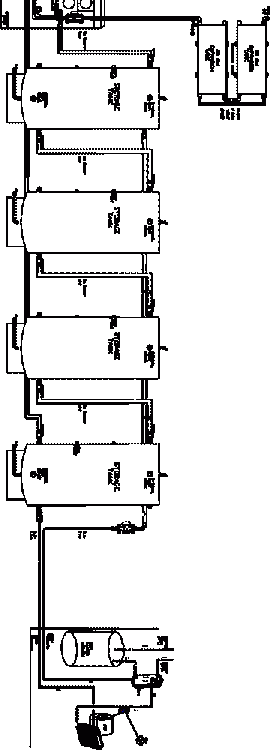

Yes it's the latter. Gasifier boiler with a HX in the forced air system. I'm unclear about "where the best place would be" to t off into the piping?

Might help if you put a diagram up of what you have now. Or is this all totally new and in planning?
hope this is good enough [Hearth.com] Adding a baseboard zone to a force air system...

Can you post the full pic of your system? You might get some improvement ideas or suggestions on this & other things - while you're at it. Be good to get feedback on the whole thing, at this stage.
For starters, I think I would plumb the tanks in parallel, and reverse return, for better stratification & heat distribution through your storage. Also not sure how your expansion is tied in there, it's cut off - and return temp protection. And I would likely T off a zone supply (supplies) between your tanks & the first HX - to quickly address your original question. And the way it is now, all the heat is going thru the DHW HX and the hot air HX at the same time. Without knowing how things are controlled, can't comment a lot on this - but I like having each heat using thing on its own loop. A problem with one thing could put the kaibosh on everything.

If you were going to go with cast iron or flat panels that were sized for low water temps, you could tap the return from the air handler. That would really drop the temps going into storage, and help your boiler maximize heat transfer. The flip side is that you will have to pump your Hx when you want flow to the baseboards, even if you dont want it for the rest of the house.
Maple makes some great points about having things in series, might be better to set up a manifold or multiple zones to heat baseboard directly instead of tapping a main loop. But as Stee mentioned, the costs might get way up there.
