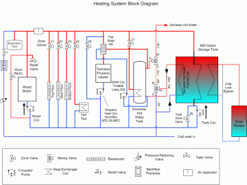

I don't know if electric units have the capacity. I'm replacing my oil backup with a direct vent tankless propane water heater.
  • [Hearth.com] Advice/recommendations on brand/type of electric boiler for backup
