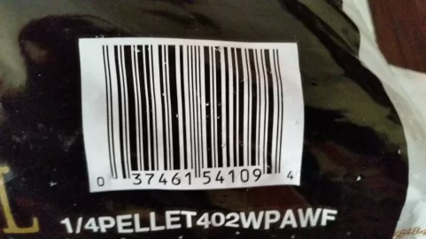

Wow, it's really interesting to hear the mixed feedback on these pellets. 10 bags in, and in couldn't be happier with these pellets. I could go probably 2+ weeks without cleaning, and the minimal soot on the glass wiped right off without any scrubbing. I wonder if this is a case of AWF producing out of a couple different plants, with some better than others. I see some really great feedback on here, and some really bad feedback, it's like there are 2 totally different pellets out there with the AWF name on them... Can you post the SKU # on yours? I wonder if they have different SKUs, and someone might be able to look into it.

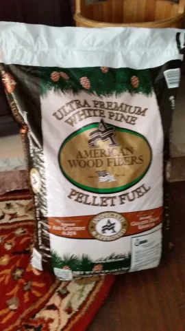

I'm with you. I love these AWF pellets. Mine burn clean and hot. I have also burn barefoot, which is a great pellet but I like these AWF pellets better. I would also be interested to see if there are different pellets out there with the same name. Here is a picture of mine.
[Hearth.com] After burning American Wood Fibers my stove is burning dirty[Hearth.com] After burning American Wood Fibers my stove is burning dirty

There are a couple of different versions of the AWF pellets. One is the "Ultra"- Pure White Pine and a Super Premium with .25% ash and 8700 BTU. In my stove these burn cleaner than Okanagan Douglas Fir ( about the same ash but less deposits on the burn pot) which had been my top pellet previously. The other is reported to be a Hard wood pellet and there have been complaints mentioned here in the forum about those. This is the first complaint I've heard of the White pine if that is what the OP has.
I can only base my comments on my own experience with the White PIne AWF, having never burned the others. Based on how the Pure White Pines burn in my stove and assuming that is what the OP has ( that seems unclear), I'd say there is something else wrong with the stove, be that setup for burning these pellets or clogged passages some[lace, clogged vent. But in my own personally experience as burned in my Harman P61a these are one of, if not the cleanest, pellets I've used yet . And especially so for a pellet that doesn't rob you blind in cost. With that said, I'm in SE Ma. If there is another plant someplace in another location supplying other parts of the country I have no idea. And also no idea if they would be producing a different pellet than here if so.
