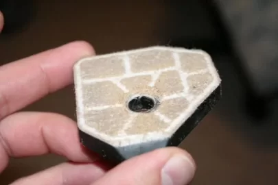

One of the problems I have found though, it that apparently the air filter is hopelessly undersized on this unit. It is a single (flat) layer membrane type filter. It is not pleated in any way, which would increase the surface area for contaminants. After a few days use from new, I found that the unit lost a lot of power and was "four stroking" all of the time and wouldn't idle. So in looking for the problem, I came upon the air filter. The pictures below show what it looks like: http://www.flickr.com/photos/11828061@N04/sets/72157602200288785/
Basically, the surface area of the filter element is so small and restrictive, that the sawdust that is able to reach the filter while cutting through an 8" round is sufficient to create a noticible loss of performance. Once the filter has been clogged a few times, it appears that all attempts to clean it are only partially effective and performance drops off after just a few minutes of use.
Has anyone experienced this problem ? Are there any replacement filter with larger pleated elements ? Perhaps replacing the entire airbox ?
Other than this issue I think the saw works just fine, but this appears to be a major design flaw.

Well, I had to do something, so I took out the filter element and scrubbed it with soap and water and tried to reverse flush anything I could out of it.
The difference was like day and night. I cut down a standing oak tree about 18" in diameter and that baby just screamed all the way. A cut through all the way in about a minute. Its the first time I cut down a live tree, everything else till now has been standing dead wood and dry as a bone, so the rate that the little saw plowed through took me by surprise.
I guess that if one cuts only dead standing wood the sawdust is more than likely finer and tends to clog the filter more severely than if one cuts green wood.
At least now I know... Perhaps I will buy a few replacement filters so that if it bogs down in the future when I'm out in the woods I have something to swap out right away.

Sponge would be a lot better than the flat paper element since it offers much more space for debris to go (storage capacity). I know how filters are designed and I'm amazed to find such a crappy filter on a tool that is obviously not going to be working in a clean environment.
I think that in my case the sawdust falls in during removal of the tight fitting element, I don't think it is a bypass.
Is there any way to swap in a sponge or other better quality filter (assuming warranty presevation isn't an issue?) I know that on many motorcycles it isn't unusual to replace over priced and/or restrictive filters with aftermarket or home-brew replacement filters - many made by cutting out the factory paper element and replacing it with various sorts of foam. The filter in your picture looked like it would fit into some sort of frame - could you get a larger foam filter and cut something the appropriate shape to fit?
I fell that on my saw it is more likely a bypass - I was watching pretty closely when pulling the filter, and usually tilt the saw when pulling the filter so that any debris would fall away from the carb. All the stuff in the carb throat is fine dust size, much smaller than most of what was on the filter. Lastly the debris was pretty evenly distributed over the surfaces under the filter - if it was fall-in, I would have expected it to be in clumps, but this looked like an airflow distribution...
