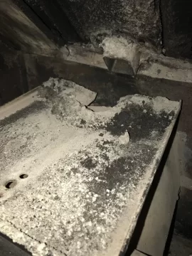

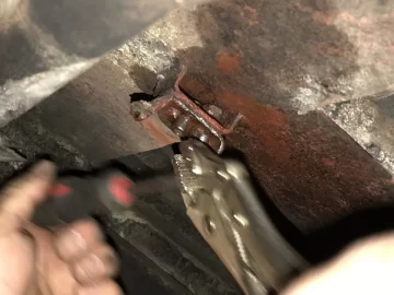

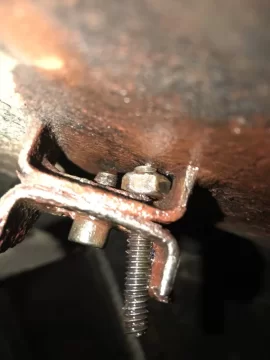

Hello

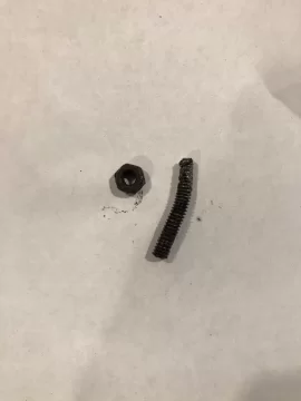

The nut turns with the threads so I cut it off!
Last pic shows bolt that turns?
Is this right?
How should it be??
What is the best fix??
See pics

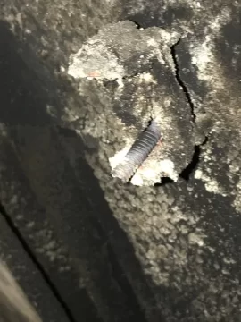

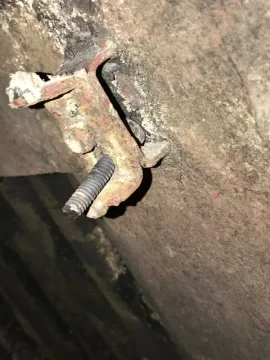

Here is a better pic of the top of the bolt that is stuck in there.
Getting it off with vise grips and a screwdriver to hold the nut!

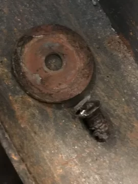

Got it out!

No it is a CB1200 Classic Bay just a very old Aladdin version. Now I think I can add some threaded rod or weld a nut in and I will be all set :-)
