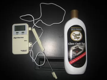

This thread is a little old but I thought I would share my experience with cleaning glass.
I've been blessed with pellets that soot my glass up pretty quick, within half a bag it's light gray. By the end of two bags it's dark gray and if I do 4 bags without cleaning it's black with no light showing anywhere. Tried adjusting air in/out no better so I live with it and tried a difference way to facilitate my glass cleaning.
I just actually finished cleaning it after a two bag burn and what I have been doing is vacuuming the door good and use a wet paper towel to remove as much as possible from glass. What I have been doing after the wet paper towel is using stove top cleaner after to polish up glass. This cleaner leaves glass silky smooth and makes cleaning glass much easier next time around.
Today I actually used one baby wipe first and glass cleaned up real quick and left no soot behind. I think that using that stove top cleaner helps by not letting soot stick to glass. Been doing this for the last 1 1/2 months with good results.
Here's a pic with the glass cleaner and a thermometer I got to play with heat output on stove.
EDIT: Just realized I jumped out of the pellet forums and wrote about cleaning a pellet stove glass instead. I also have used the same stove top cleaner in my wood stove but not as much. The wood stove is on 24/7 so it doesn't get cleaned as often as the pellet stove which runs just a few hours per day and off nights.

I'm willing to bet that rutland glass cleaner is the same stuff or made the same as Weiman that I'm using for my glass stove cooktop. Never heard of the rutland till now but I've been using mine on my stove top glass for the last 11 years and started using it on my pellet stove end of last year. I think what I paid for that bottle about 2 years ago was $6 and it's a 15 ounce bottle. It lasts a long time as a little goes a long way on cold glass.
I would agree that there is sand in the ash and it may or will scratch glass in time and that is the reason I vacuum around glass good before wiping with wet towel.
