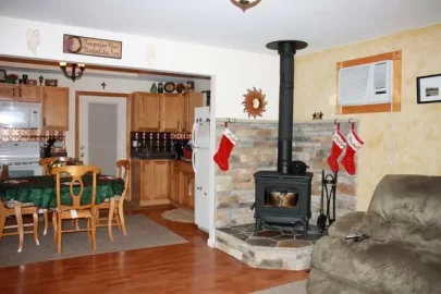

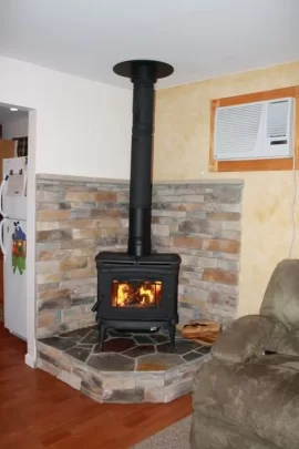

Wow, thanks everyone! I was able to adjust the latch like CSAW suggested and it works fine. Glad I found this forum, Im a total newbie and have learned a lot just browsing around here. I attached a couple of photos of our stove.
Mike

wow!! nice setup, surfx. Stove doesn't look small at all. Thanks for posting the pics.
