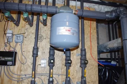

Got pics or a drawing?

I attached a picture. [Hearth.com] Amtrol Air Purger and Taco Hy Vent & Expansion Tank
