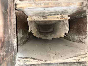

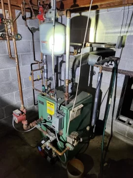

My old farmhouse is due for some upgrades or an overhaul to the heating system. I would appreciate some input to help me determine the best action plan. I'm located in south-central Pennsylvania in a 2500sq ft stone farmhouse with the plan of this being my forever home. I have 20 acres of forest plus my neighbor's forest that can supply me with endless firewood if I put in the effort.

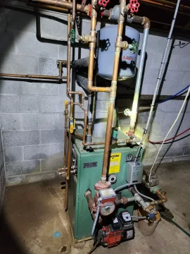

The Current System: The main boiler is oil-fired with a DHW coil, 1 zone that supplies heat to my upstairs and downs stairs loops. Manual valves control the balance of the heat between the two hydronic baseboard loops. There is a fireplace insert boiler that is tied into the oil boiler with an aquastat and circulator. The two systems share the same water. The fireplace boiler is in my living room while the oil boiler is right below it in the basement. The fireplace boiler heats the oil boiler, sending heat to the baseboards and DHW coil. The equipment is believed to be circa 1984. Likely the oil boiler and fireplace insert boiler were new when an addition was added on to the house. Both are operational and in decent condition, if they are that old.

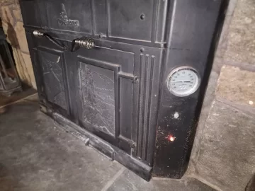

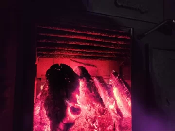

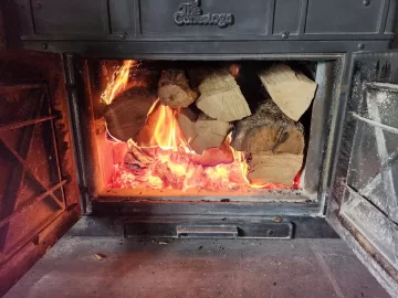

My first winter experience: The fireplace is working better than I expected. I gobbles up wood but I was able to maintain 70deg temps when it was single digits and windy this winter. Despite the mild winter, I believe that I burned 3 chords of wood during the month of January, so 15 chords+ for the year is what I'm planning for next year. I have boiled over the system a few times learning how it all works and was fortunate to not experience any significant power outages. The fireplace bubbles more than I would like. This is likely because air gets trapped at the high point and the water can begin to boil if you let the fire get too hot. There is no hot water storage in this system. Once the water temp reaches the high limit on the oil boiler (160F) it forces the circulator pump to distribute heat to the zone till a low limit (~140F) is reached. The oil boiler does not run until the low limit of 120f is reached during high demand or when the fire goes cold.

  • The fireplace overheats water on startup if too big of a fire is made until the aquastat turns on the circulator.
  • The fireplace makes bubbling noise more than desired requiring purging.

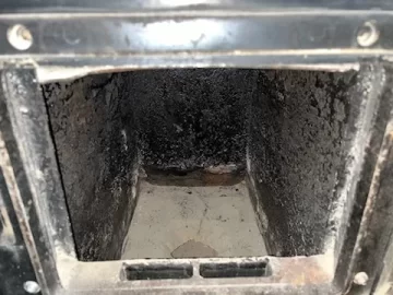

  • Cresote build up on water tubes in the firebox and are basically impossible to practically clean.

I haven't found any information on the internet about the insert wood boiler. Maybe it was custom built....
If your in your 30's now is the time to do it ,the payback will be huge! Did my system when I was in my 30's (1980's)was the best investment I ever made . Froling ,Vedolux with storage , no danger of chimney fires and very efficient !
Here is a better look at the wood boiler. The oil boiler is a New Yorker S-114-AP 127kBtu. I have no idea how old they are but both are functioning "fine". I didn't calculate the payback but 20k is not in the budget now. Ultimately, I can make no changes and still heat my house on wood only. In the fall before I started using the fireplace, I consumed 100 gallons of oil rather quickly. I haven't fully grasped the time required to stockpile enough wood but don't want it to consume me.

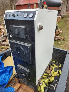

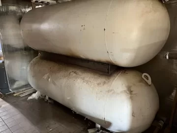

Yes, I am comfortable accepting this challenge. Digging around on FB market place has turned up some Tarm Solo PlusII units and a Vedolux 37.
Vedolux 37 build in 2011 with 2 500 gallon storage tanks asking $4k. This could fit the bill.
With the Vedolux and storage your wood consumption would drop to 3 1/2 to 4 1/2 cords a year !
Maybe, but that seems a little optimistic. Although the EKO is crude I don't see how it could burn the wood any more efficiently. I could probably save a cord if the boiler and storage were inside the heating envelope.
Reducing my wood consumption would save significant TIME. So getting away from this stove would be beneficial and safer.

I would jump on that Vedo, fast, before it gets sold. Thats a great deal for that plus storage. Unless it's been seriously abused somehow. You might find a comparable brand but you won't find better. The dealer is in PA, and is awesome.

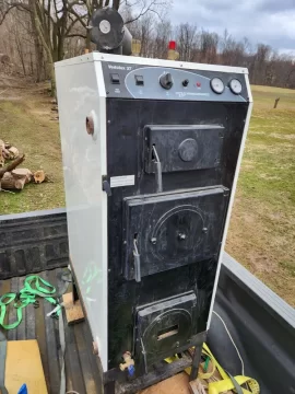

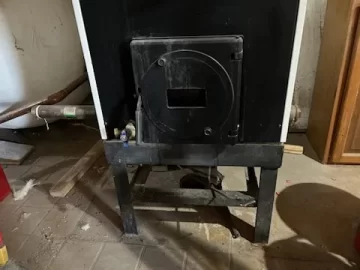

I got some pictures of the stove. It looks worn but I'm no expert. The tanks are also too big to fit through my basement door and I don't have enough headroom to stack them. So I might let this one pass.

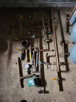

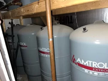

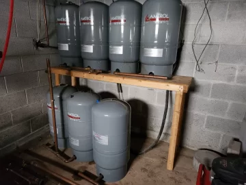

View attachment 310777 View attachment 310778 View attachment 310779 View attachment 310780 View attachment 310781
Holy Crap! Look at all the expansion tanks. There must have been a couple thousand dollars right there!
I would get input from Dean (dealer) on the condition of that. I am not directly familiar with the 37 but that kinda looks like just a refractory replacement. Then if he gives favorable input, I would still jump on that. Even that price for just the boiler and expansion is a bargain, even if you can't use those storage tanks. Maybe he would have something smaller you could trade them for? Big bonus is you would have a (very good) dealer for what you are using close by.
I picked up the unit. $ 2700 for the boiler, expansion tanks and miscellaneous piping components. The 2x500 LP storage tanks were left behind because they won't fit through my basement door and I don't have enough ceiling height for them.
