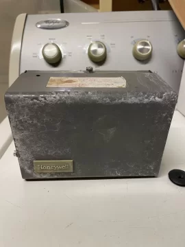

No issues with my shower Thurs morning at 0400 but wifey said hers was a bit chilly at 0600. She got home at 1715 to a house at 58 deg with high winds and a cold front moving in and said WTF? and lit the wood stove. I got home at 1900 and heard the bad news. Investigation reveals the oil boiler stone cold at 70 with the fire eye tripped. Reset fire eye and it took off ok, heated up ok, got above setpoint, then circulator started ok since the house was still at 64 but it continued to fire to over 200 when I shut it down.
Cycled the low limit setting. It clicks on and off.
Cycled the hi limit setting. It doesn't click on/off, so it seems like it's stuck on and allowing the boiler to overfire to a high temp.
Opened breaker, pulled knobs off aqua stat, removed 3 screws, removed cover, found white crusties, (evidence of slight water contamination from a slightly leaky DHW fitting) and a brown sticky substance (solder resin?). Cleaned this up with electrical contact cleaner. Looks brand new again. Re-assembled. Low limit seems to work ok. High limit seems way off, it still wanted to overfire to 200 deg. Shut it off for the night.
Turned it on and watched everything as she showered Fri morning. Low limit / diff seem to be working ok. Still not sure if high limit is AFU / reliable since the house is warm due to wood stove.

Wound up going with the Beckett AquaSmart 7610A0001U. Wifey's cousin works at the local plumbing supply store and had one in stock for only 3 bucks more than a popular online retailer. Very happy with it so far.
Beckett claims 10-20 % oil savings due to their "heat manager" program. Probably won't qualify for any rebates due to it being self-installed but they guarantee 10% savings or they refund the purchase price. Got to love that kind of faith in your product.
We've had the wood going for 8 days straight and so far over the last 2 days the AquaSmart is almost always kicking into economy mode where it lowers the high limit when not constantly getting a call for heat so this saves standby losses up the flue.
