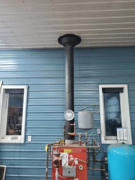

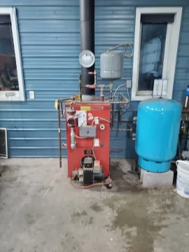

I'll throw in some pictures of the oil boiler I had planned to replace with the wood one.
