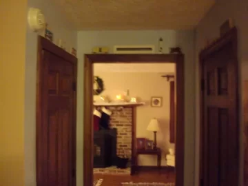

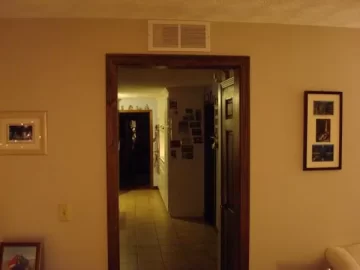

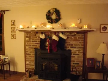

Here are the pics you requested by email. Sorry about the quality.
The first is the intake side of the Tjernlund AirShare fan. The second is the output. Due to the layout of my house I couldn't have the output at floor level which would have been preferred. Here is a link http://www.tjernlund.com/Tjernlund_Aireshare_Stuffer_8500801.pdf
The last picture is the LUX WIN100 Heat/Cool thermostat that my fans are plugged into (to the right of the wreath). You'll notice it's positioned high so that it senses the air temperature that will be pushed from the stove room. It's set 2°F above the stove thermostat so that it doesn't come on unless there's a temp differential worth sharing with the rest of the house. Again, a link (broken link removed to http://www.luxproducts.com/thermostats/win100.htm)
Unfortunately the pics were snapped during quiet time. The stove cycled off and the fans were also off. I hope this helps with what you were asking about.

sweetsncheese said:
LJ4174,

Ooh .. don't remember where the fans came from. Just google the name and you'll find them for various prices. They're pricey but look clean when installed. You can hear them but they're rated as one of the quietest options out there so I can't offer a better choice. I purchased the direct wire type. The wires run inside the wall and down into the basement to a junction box. Out of the box I brought appliance cord and a two prong plug up through the ash door (same path the pellet stove power runs from). It then comes out from under the stove, along the wood trim beside the brick up to the fan thermostat. You might be able to see the cord running behind the Coal Hod and up the wall to the thermostat in my poor pics. The thermostat plugs into the wall outlet just above the mantle as seen in the pics.
The fan thermostat came from Amazon. Again there's experimenting that happens with it as well. Set it low enough so that it turns on when there's heat to be pushed but high enough so that it shuts off for a bit to offer piece and quiet (I'm a forced hot water guy so noisy heat still distracts me). Mine is set 2°F above the stove thermostat. The fans typically come on about a 1/2 hour after the stove starts up and remain running about 1/2 hour after the stove shuts down.
