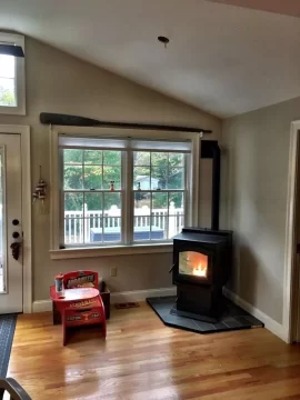

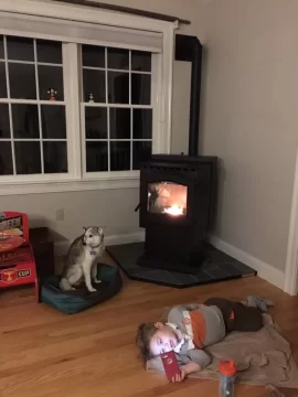

UPDATE:
Finally had the P68 installed and burned 2 bags of "Green Supreme" which is average pellets from most people I talk to.
Wow this thing gives off amazing heat even at lowest setting.
Only things I am trying to understand/get used to:
1 - The auger seems to feed the burner ohhh every 15-20 seconds....is this normal?
2 - The auger is louder than I expected....but nothing too crazy and assume normal as well.
I couldn't be happier with my selection.
  • [Hearth.com] Another Harman thread - P61A or P 68 for 2700SF (2500SF on 1st floor)?
UPDATE:
If you think it's doing well with GS pellets wait till you get some hot pellets.
Congrats on the stove and it's success !
The auger motor makes a little whir, the tinkling sound are the pellets dropping past the gate. And yes about the timing, that all sounds about normal, will vary a little according to what mode you run the stove in.

Looks like you have a happy crew that you are sharing the warmth with.
Reactions: Bontchimuz

Man this forum is a GODSEND of information.
Thanks tonyray and alternativeheat for that info. Yes, bogieb my son instantly laid on the floor in front of it when he got home from daycare lol.
