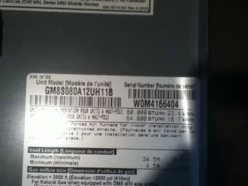

The first issue is there is no manufacturer stamp anywhere I can find and from the HVAC guy down town he says that it is a 25 year old furnace. ( I have no idea if that is true or not and cant find any info online ) It already runs like crap makes a lot of noise squeeks and shakes the hole darn house too. :rolleyes:

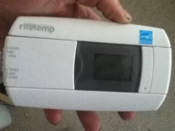

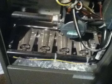

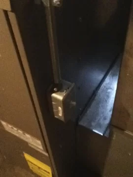

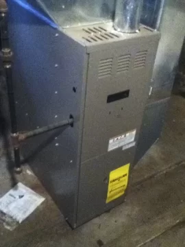

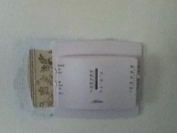

Ok so my first thought was it is a faulty thermostat so I went and bought a basic spring one to replace the digital and see. So far it has worked better but not well ! I have had to turn the thermostat off & on twice to get it going. My next conclusion is it must be something in the furnace. Anybody have ideas ? Here are some pics of the furnace and thermostats. At this point I do not have the money to replace it and refuse to take a loan seeing as we use a wood stove only really need it for backup anyhow so we would like to fix it if possible.

I just found a manual taped to the back of the water heater and it looks like the manual for the furnace .:rolleyes: ( Previous owners put a lot of things in really odd places too ! ) It says Models GY85 / GM8s / LY8s / LM8s / LF8 ( single stage uplfow / Horizontal / LoNOx ) What does this all mean ? There is still no name on the manual either !

Check the 24VAC supply. If it was running low, the digital tstat might act flaky, and even the coil one might not reliably fire the furnace controller?
Just put an AC meter from R to C, or red to common, at the tstat. IF its low, then you have to find it...prob in the furnace...but relatively easy/cheap to replace.

Ain't a HVAC tech but my google-fu tells me that it is a York Luxaire furnace.
Reactions: Pallet Pete
Thanks BB I just finished googling it too ! ==c The furnace is officially dead now It wont run or do anything for that matter :mad: so I guess I am gonna have to go get a HVAC company to look at it. If it is an expensive repair I am just gonna install a wood on furnace instead although I have no idea where I would put that much wood !

We had the exact same issues as you do. When we called a hvac tech, they told us the gas valve was faulty. At 450 dollars later they left. The next day we were having the same exact problems and was told it was a bad exhaust fan. At this point we were told to leave the cover off which was dangerous. Six months later it occured to me that the first burner would fire but no others. In the end, it was some corrosion between the burners. The furnace hadn't been used enough and the intake and exhaust were open to the outdoors. More than likely condensation had caused the corrosion. I made a tool from a piece of sheetmetal that was long and hooked back where I could get in-between the thin parts of the burners to open the gap. Dad had problems for a few years before selling us the house and I had problems for a few years also before correcting it. Many techs couldn't find the problem. Since I found the issue the furnace fires every time, not randomly like it used to.

-Cleaned it red the flashing red light cleaned the whole thing changed a 5 dollar relay problem solved !
